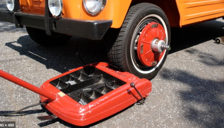

    I grew up using on of these Hunter spin balancers. Once in a while a car would have the speedometer hooked to a front wheel. Then we could see it spin up the wheel to speeds in the 100 MPH range. If you had the touch, there was no better balancing anywhere.

    This! I’m kinda surprised you new about those, I have access to those, they do work great but are kinda scary.
