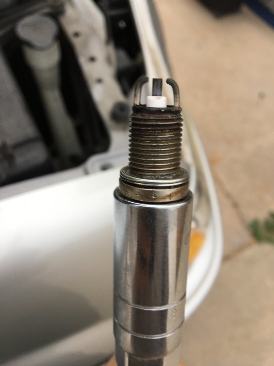

    I think you need to replace the plug wires. Plug looks fine to me. What codes was/is in throwing? Also, it is not uncommon to get a bad plug straight out of the box. A hairline fracture in the porcelain can cause a misfire.

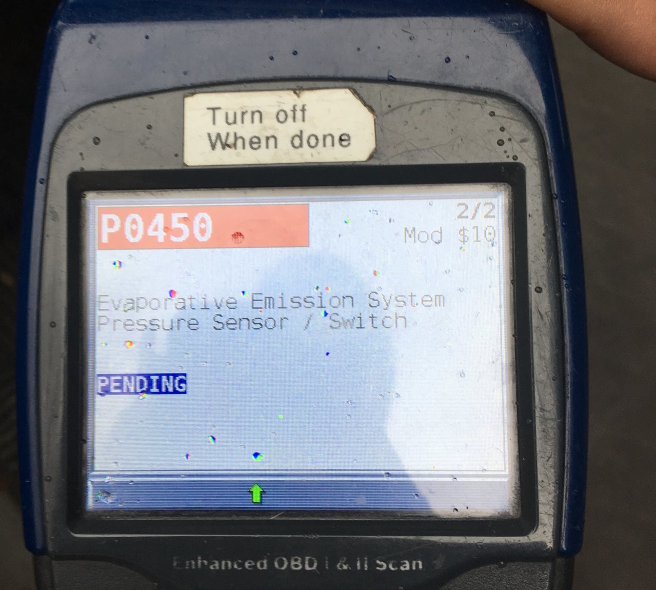

    here is the code it was throwing. The CEL did turn off about two days after it threw it. I found a sensor for cheap that I held onto until yesterday I replaced it thinking it could be the issue but it got no better. Gas cap it on tight, ect.

    This is what the OBD2 scanner said. If I step on the gas from a stop or on the highway trying to pass someone it just lags and is gutless.

    I copied this directly from a thread on the customtacos forum(credit where credit is due, right?):
    P0450 (5VZ; 2001) Evaporative Emission Control System Pressure Sensor Malfunction
    DETECTION CONDITION:
    10 seconds or more after engine starting condition (a) or (b) continues for 7 seconds or more: (2 trip detection logic)
    (a) Vapor pressure sensor value < -3.5 kPa (-26 mmHg, -1.0 in.Hg) (b) Vapor pressure sensor value 1.5 kPa (11 mmHg, 0.4 in.Hg)
    PROBABLE TROUBLE AREAS:
    - Open or short in vapor pressure sensor circuit - Vapor pressure sensor - ECM
    TROUBLESHOOTING PROCEDURE:
    The FSM diagnostic procedure proceeds as follows:
    (1) Check voltage between terminals VC and E2 of ECM connector
    Good (Voltage: 4.5 - 5.5 V): Proceed to Step 2 No Good: Check / replace ECM
    (2) Check voltage between terminals PTNK and E2 of ECM connector
    (2a) Disconnect the vacuum hose from the vapor pressure sensor.
    (2b) Using the MITYVAC (Hand-Held Vacuum Pump), apply a vacuum of 4.0 kPa (30 mmHg, 1.18 in.Hg) to the vapor pressure sensor.
    NOTICE: The vacuum applied to the vapor pressure sensor must be less than 66.7 kPa (500 mmHg, 19.7 in.Hg).
    OK: (2a) Voltage: 3.0 - 3.6 V (2b) Voltage: 0.5 V or less
    Good: Proceed to Step 3 No Good: Check / replace ECM
    (3) Check for open and short in harness and connector between the vapor pressure sensor and ECM
    No Good (wiring fault found): Repair or replace harness
    Good (no wiring fault): Replace vapor pressure sensor
