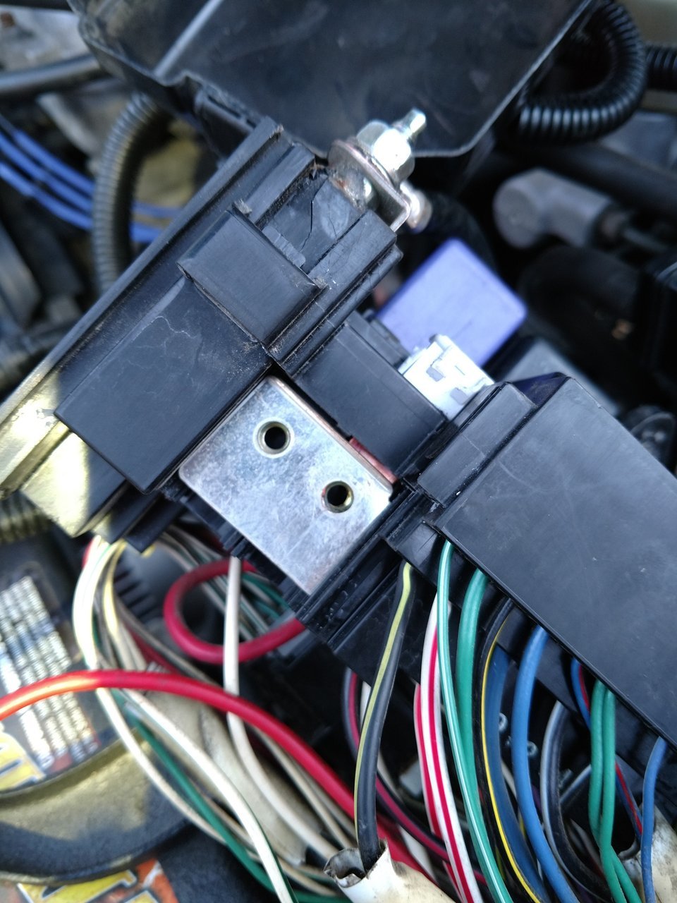

    Lol... Too late, but I think I found my problem.... The buss bar (at least that's what I think it is) is not making full contact with the main 120amp fuse...cause I'm thinking there should be a bolt here....2252018193014.jpg
    When I put pressure on it I get my full 12.5... I let off... I get 3.5

    Winner! Yeah there is a small bolt that goes in there, no idea what the thread is though.

    ...found a bolt that worked... I've got power to my interior lights... Now to hook everything back up to test..... Oh my goodness... Oh my damn!

    She started...and ran! Thanks @Snowy for pointing me to that AM2 fuse...that was the direction I needed to go... One God damn flippin' bolt... and I tore the truck apart to find it...
