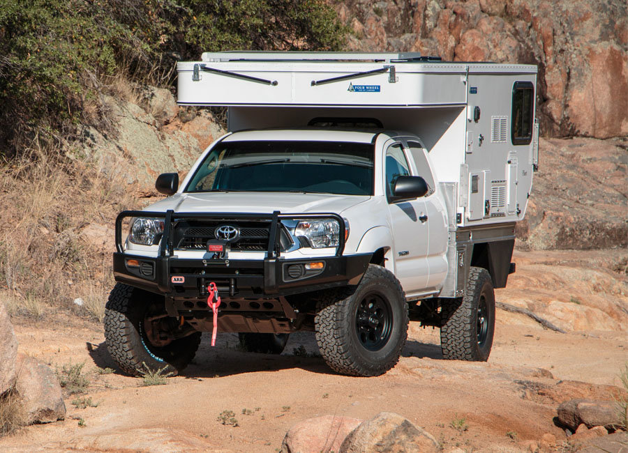

    Understood, most guys on here don't really have any experience with campers on Tacomas. It's understandable to be concerned with how your Tacoma will haul the weight of a camper around. In my opinion, if you keep the weight of the camper around 1k lbs, use E Rated tires, and install a quality suspension system that includes a higher spring rate front and rear, then your truck will be able to haul the camper around just fine. Just don't expect it to go anywhere fast.
    Air bags are great for leveling but not so much for actually aiding in increasing the vehicle handling the weight better. In Australia where they can actually authorize GVM upgrades, a GVM upgrade would consist of new leaf springs, upgraded front coils and new shocks and struts.
    Hope this helps!

    The 2.7 is what you have, but if you can see a way to swapping the 2.7 for a V6 truck, that opens up a lot of options, the V6 tow package being the main option-opener for fulltime living.

    270ish, which isn’t much compared to some campers but still large amount (35%) more than what you posted.
    A 4WC flatbed model might be the best option for a live in camper that’s limited to the Tacoma’s size and payload. Personally I’d find a travel trailer to tow or buy a different truck that can carry a decent camper.

    I was just quoting the number I had seen on the GFC website a while ago. But that doesn't change my point that the weight of the GFC is much more in line with the capability of the Tacoma than a 1000 lb dry weight camper.
    The 4WC flatbed model will also easily exceed the GVWR of the Tacoma, depending on what else is carried. Their website lists the lightest flatbed model at 1295 lbs, and I assume that doesn't even include the flatbed structure. Add a the bed structure and a driver and it's overweight. Nevermind carrying any actual gear, accesories or water and fuel.
    I'm not saying these aren't good campers. I'm saying the Tacoma isn't the best platform for them.
    Nice looking set up on their website. Anyone want to calculate how far over GVWR this one is? I'd be interested in hearing from 4WC owners that actually off road with this setup. I WISH a Taco did well carrying one but I'm skeptical.

    you're truck is not rated to carry the weight and your engine is underpowered. that's honest.

    Just about everyone on this site exceeds their payload rating, it's not hard to do with a small truck, a couple passengers and some gear, much less added armor and fun stuff. The truck can handle it fine if the individual decides the benefit outweighs the potential risk.
    A GFC is light but it's not liveable compared to a FWC. Like I said though, in my opinion the OP would be beter off to tow a trailer or buy a new truck.

    Payload on your truck is only 1175 lbs. Be careful!
