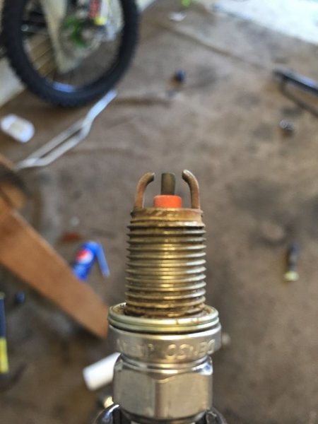

    image.jpg Cleaned the iac, tb, maf and checked the plugs...the plugs look good. Changing plug wires Tuesday when they come in

    Hmm I drive it all around no codes nothing and not really much power loss and doesn't stall at all...idle is only affected slightly.. Doesn't seam like a miss ...my truck was pretty loud/throaty before but now t has like a thumping exhaust type sound
