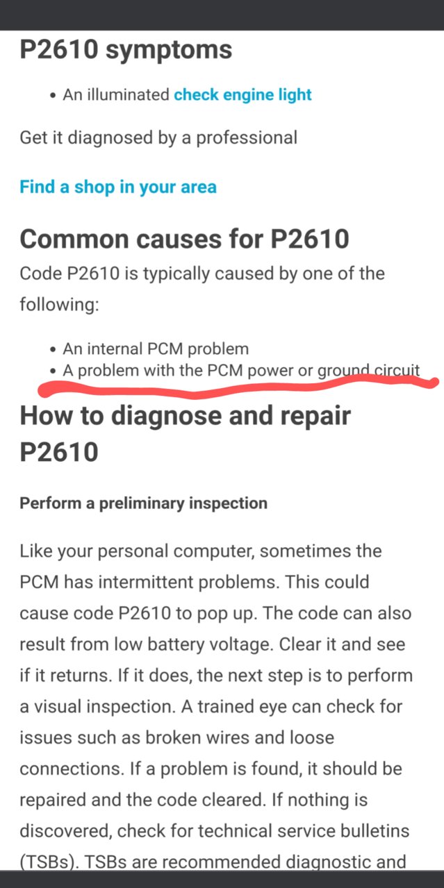

    ScanGuageII threw code this am - P2610
  5. May 3, 2021 at 4:34 AM
    Jeffch
    Jeffch Well-Known Member
    Dec 23, 2011
    #69251
    3,245
    Jeff
    Vermont
    2018 off road
    Running 285/75/16s
