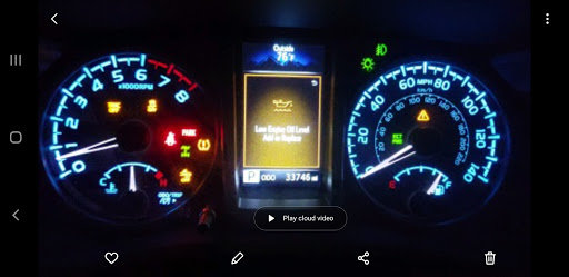

    Hey guys,
    2018 DCSB TRDOR4x4 AT
    There have been maybe 4 times where I'm trying to climb a steep hill and the engine turns off. This has only happened when doing a steep incline.
    Has anyone had this issue or know what could be happening?
    I got a warning on my dash last time this happened which was resolved by driving for a minute. Oil level is fine according to dipstick on level ground. The other times I did not see a warning but maybe I missed it.
    Cheers!

    I have done long climbs and been fine, I've also stalled at the bottom in super sandy situations. It doesn't seem to depend on how long/high I'm climbing. Every time I have stalled I have been at sea level.
    I called down to the dealership, my truck does qualify for the fuel pump recall which is being done on the 18th.
    Hope this answers your question.

    Is your Taco an AT? I've heard they like to stall when they roll back (even a little bit) while in gear.
    Junkhead and WarFab Armor like this.

    Yup, it's an AT. Maybe I am just experiencing the roll back engine cut off then? I will try to pay closer attention to that.

    Mine stalls when you roll backwards while in gear, happened a few times. Its also happened while in reverse if I put it in drive before coming to a complete stop.

    The above video is from September 2017.

    @Just1n
    When I looked at video, that's what I thought to myself (again), that maybe I should invest in a catch can...
    Your replies basically confirmed that it's a good idea.
