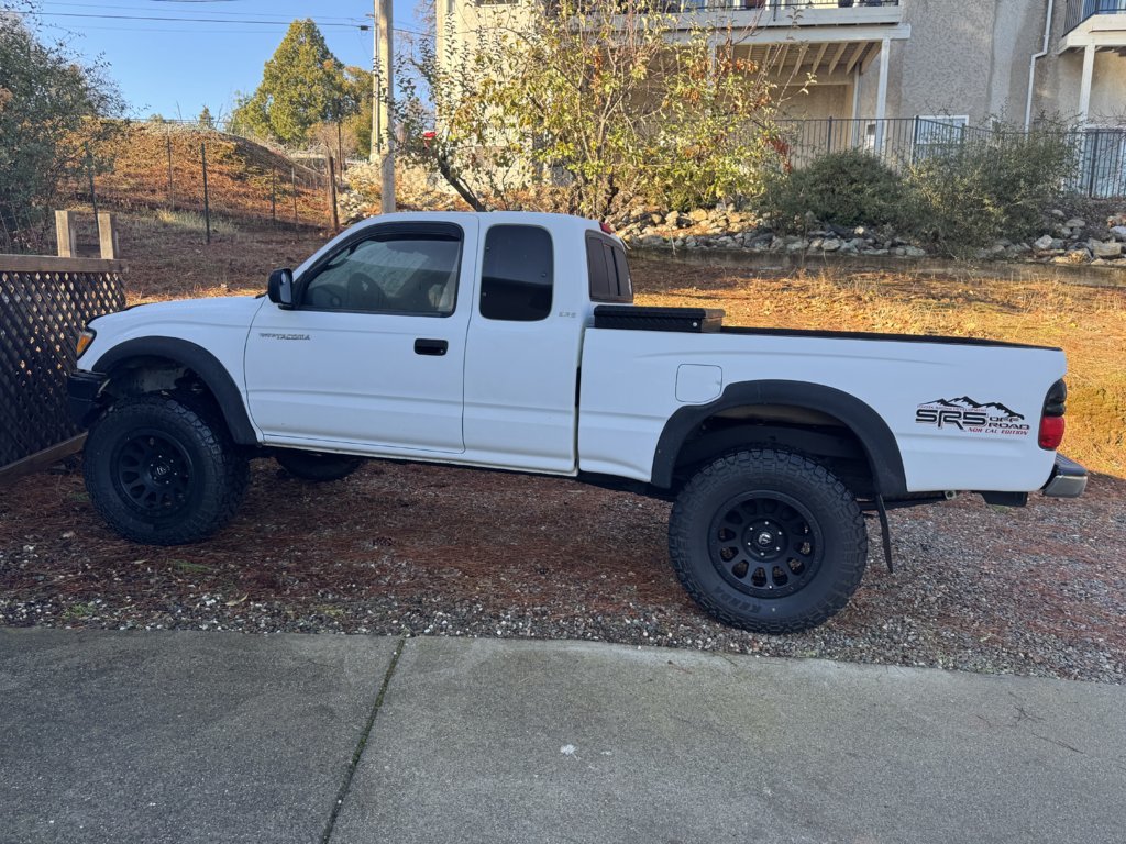

    When I put it in drive and go to give it gas it barely creeps forward if at all. I’m talking a foot. And if I give it more gas it’ll stall out and die. It will roll in neutral just fine. If I have it in gear and on a hill it will roll just fine. Almost feels like my parking brake is engaged but it’s not. Only when I put it in Low will it move a little better but I still wouldn’t call it normal, even for Low. The engine sounded like it was misfiring for a bit, but that has smoothed out now. I did have a very strange cold start that’s hard to explain lol. And we did get rain last night.
    It has only done this once before and last time I left it parked for a day or two and then it drove perfectly normal like nothing happened. My temps are great via scangauge and I have NO NEW CODES. Last time this happened I didn’t get a code either. I have 318,000 on the truck and maybe 20,000 on a fresh head gasket and two new heads that I replaced myself. Spark plugs and wires were replaced last year too with denso and NGK. My gut tells me the transmission is starting to get finicky with its current mileage. But Idk for sure.
    I’m fairly mechanically inclined for my age (I like to think) but this has me stumped at the moment. This is my dd so I’m not too stoked with the situation. Open to your thoughts and opinions. Thx gents.
