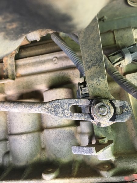

    There's a linkage underneath the shifter connecting to the transmission. If I remember right it's adjustable?
    And wearable.
    Make sure it's actually shifting or in the correct gear.

    The shift linkage, I posted about eventually wears out from all the back and forth. If the truck isn't truly in P or stuck somewhere in between gears, the truck may not start.
    Could also explain why it starts only sometimes or didn't hardly move when it was started.
