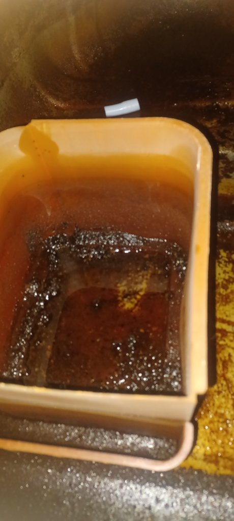

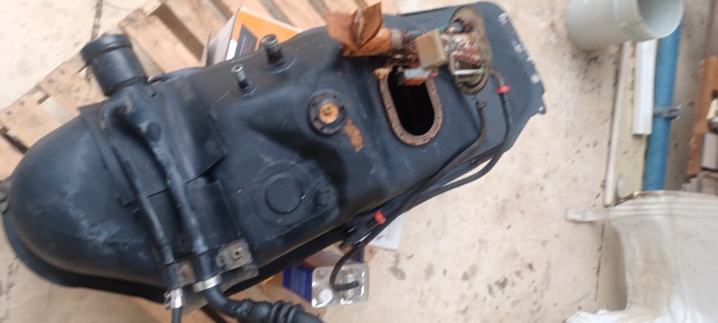

    Hello, what @TRoss1 said, Here is my gas tank after 3 years of sitting with like a quarter tank in it. I was getting everything in order to install new engine. I had to refurbish the fuel hanger assembly add new fuel pump and sock to start new engine. You can purchase a whole hanger assembly or just a pump. And hanger clean up. I pressure washed inside tank and Dawn dish soap. Could be your problem.
