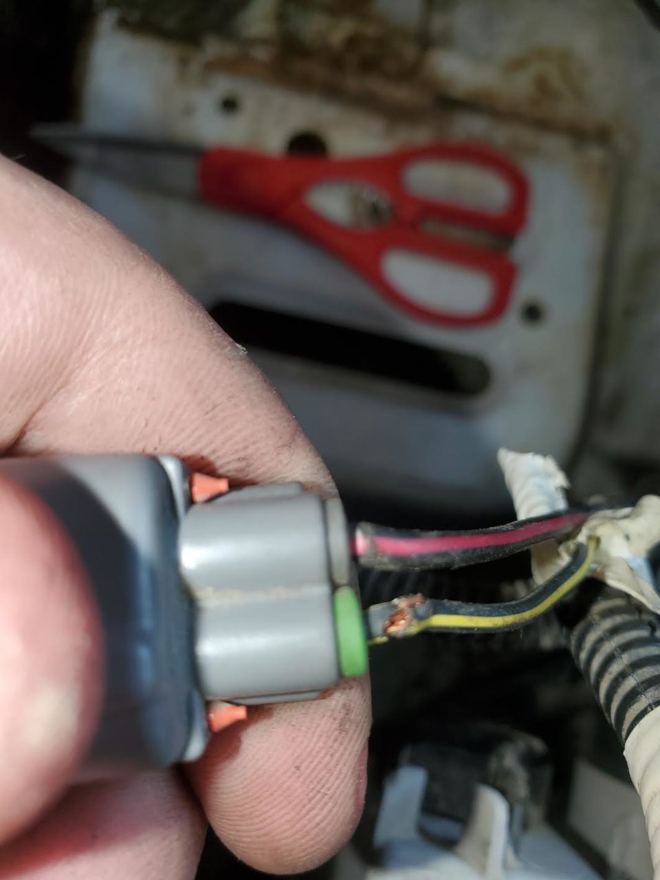

    Well, today I decided to look a little deeper into the wiring and noticed this when I bent the fuel pump resistor wiring. It bends when it's plugged into the resistor and it's straight with the bypass. This is a PSA to always check your wiring.

    Looks like the mice have been hungry.

    another victim of soy supper.

    How did you fix the wire?
    Or this could be a new issue. Start over diagnosing. Check engine light lit? New error codes?

    I used crimp connectors to wire it. No check engine light.

    Crimp connectors will do but solder and heat shrink is better. Post pictures of the repaired wire. Not sure how you were able to use a crimp connector when the damage is so close to the plug.
    You could bypass the resistor, test drive. If the problem goes away then the repaired wire probably needs to be redone. Or maybe the plug isn’t snapped in tight?

    I removed the old plug and directly connected it to the wiring into the resistor.

    When time allows it would be a better fix to find a new plug or used junkyard part cut back far enough to do a proper solder and heat shrink.
    As long as it's not stalling on you, I'd drive it awhile before tearing into anything else.
    Bummer you've had all that other work done and it was most likely that connection all along.
