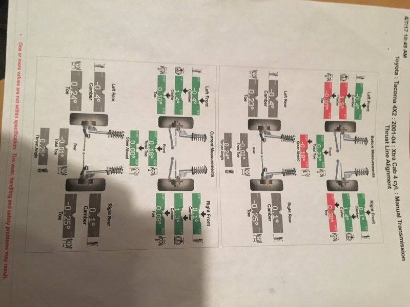

    So I ended up going to the stealership (against my best judgement) and had an alignment done there. This is the printout I got and they said it could've been my bearings causing the issue, STILL pulls to the right and this was after I paid $240 for an alignment and labor for repacking the grease on the bearings (labor costs), I just want the thing to track straight long enough for me to grab my coffee from the cup holder without running of the road....

    So, you said base, and bearings packed, so 5 lug, right?
    Take it to a real alignment shop. After which, they will be able to really tell you whats up. If its something simple, you can throw that in the dealerships face.

    You can try cross rotating your front tires so move your pass front to driver and driver to pass and see if the pull is still there. You also have a slight dog tracking in the rear with the toe being to the right. Unfortunately this can't be adjusted that's why it's grated out.

    Wyoming09: in my case, it's very similar to yours, it doesn't seem to track to the right until I hit about 25-30 mph and Ive checked for brake dragging issues, no luck. If I'm driving in the left lane with the road crown going to the opposite way it will drive strive or practically climb uphill depending on the severity of the grade.
    Wht95scort: ive tried cross rotating the tires every which way and still no luck, so I've ruled out a radial pull completely.
    Digitalferg: I've been to 2 well known alignment specific shops in the area and they've both completely messed up my truck, the dealership is the only place where ive gotten them to get it the closest to tracking straight, I'd just hate to have to go back in and tell them that something's not right, and it be this much later, because I know for a fact they would charge me again, and I'm already $300 in the whole JUST for an alignment.
    Also does anyone know how caster/camber shims work and where they are placed? I've read that caster can cause a pull to the side with the least amount, and by the print out, the front right side has the lesser amount of caster. I was thinking I could put a shim in and see if it changes anything depending on the involvement of doing so. I've also read up on camber bolts but idk if those change caster at all. Just curious on others thoughts, I'm still learning how to work on my truck. Haha

    My opinion,
    camber to low on left front wheel and caster lower on right front wheel, The combination of those 2 can cause what you are describing. camber as you see is at the bottom of the spec. should be equal to the right side. caster should be the same. vehicle can drift/pull to the lower side of caster. On the print out, those arrows should be centered for the optimum alignment setting. If it were me, camber set to 0.1+ both wheels, caster left front 2.0+ and right front 2.1+ then set toe accordingly. I worked for Toyota and based on that print out, that alignment is wrong......

    Ed,
    That makes a whole lot more sense, and thank you for the feedback, I really appreciate it brother!
    Also considering you said you've worked for Toyota, do you have any knowledge about caster/camber shims. From what I've read that seems to be the only way to adjust those two factors.

    No problem,
    Shim thickness has to be determined as to what degree of adjustment is required. I would take the your truck back to whom you paid and have them fix it right. It's pretty obvious based on their own provided print out, that it's not right. They always say, "It's in the Green" so it must be right, The numbers tell the truth, Not the color. Yes, 15 years, total 35 years in the business, recently retired from them. Does a 2002 have lower control arm cams for adjustment? looks like this right?

    Yes sir, that's the set up I have. The mechanic at the dealership that did my alignment said that camber and caster on these model trucks weren't adjustable which I found hard to believe. He said they were set from the production line and toe was the only adjustable part, which I've monkied with quite a bit. Is it true the caster/camber combination that you're explaining can cause a drift/pull?

    Also I think the LCA cams are fixed, but you can buy adjustment cam bolts for around $20-30
