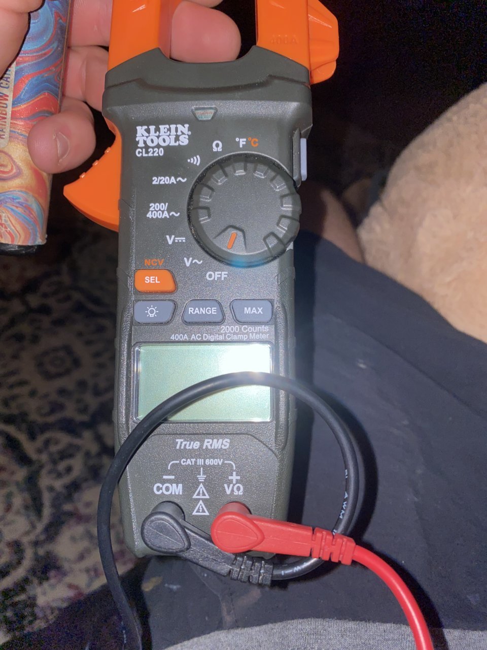

    Can some one please explain to me how to check the wire and ecm or pcm with the meter I have. I put pic of it on here. It showed code p0356 and I have changed coil 2 times and spark plug 2 times.
    I’m don’t know much about wiring or a meter but if it is explained I hopefully can do it

    P0356 means the PCM is not receiving an ignition confirmation (IGF) signal from the number 6 ignition coil (drivers side rear), this can be caused by a faulty coil, a bad power or ground to the coil, an open or short in the control (IGT) wire, an open in the ignition confirmation (IGF) wire, or a bad PCM.
    The first and simplest test is to swap the coil to a different cylinder and see if the code moves to the other cylinder, if it doesn't the next step is to check power (Black/Red) and ground (White/Black) at the coil with the key on.
    If those are good you will need to check wiring integrity on the IGT (Green) and IGF (White/Red) wires between the coil and the PCM.
    If that's good you will need an oscilloscope to check the signals.
