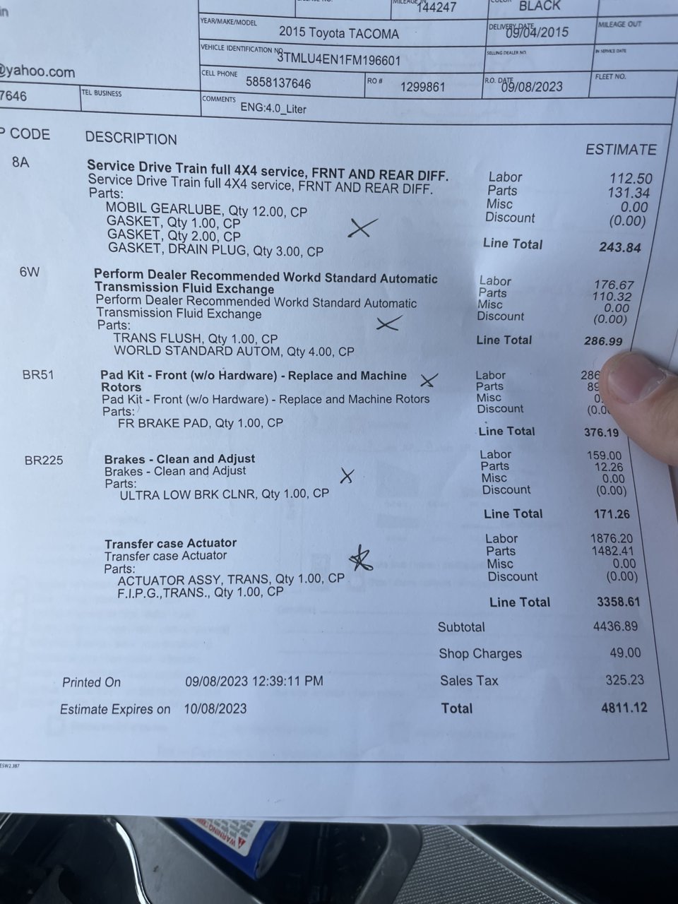

    Hello all
    First time posting on here, looking for some possible advice/insight. Last week I was doing some off-roading on a mountain pass. I put my truck into 4Lo for a short section and when it was time to disengage, my truck refused. I babied it down the mountain pass until dirt road met pavement and got it towed to a mechanic who thought the switch and wiring for my 4WD knob went bad. That did not fix it and they advised me to take it to a dealership, the dealership told me the actuator is bad and quoted me over $3000 for parts and labor which seems insane. Am I incorrect or should I source the parts myself and go to another mechanic?

    That dealer quote you showed is insane. You're stuck in 4Lo and they want to service both diffs, the transmission, and the brakes..... along with the TC actuator, which *might* be necessary. I can't tell you what it's gonna take to fix your truck, but that dealer is bending you over. Is there a reputable independent shop in your area? Might be worth a try. Good luck, let us know what happens.

    I think you should share the link that @Dm93 posted with the first shop.
    That way they can be better informed.
    Then ask the dealer if it is“really” necessary to replace the whole transfer case actuator.
    90% of the time it’s NOT……. (A good tech will know)
    You don’t make as much money replacing part of the actuator.
    And technically, you are not replacing the “whole” part the customer paid for.
    On the other hand, the customer will save hundreds of dollars if you just replace part of the actuator.
    In the end, it’s going to come down to time and money.
    Do you have a little free time and want to save some money?
    Do you have a voltage meter, a basic set of hand tools?
    If so, you can save A LOT of money.
