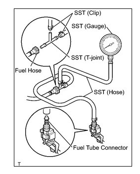

    That leads me to believe there is a problem within the fuel system.
    Here is a picture on how to check fuel pressure using the Toyota special tool.
  19. Jul 1, 2022 at 6:33 PM
    #19
    GrampsTacoma23
    GrampsTacoma23 [OP] Just hit 100k Club
    Jan 20, 2022
    #387891
    124
    Jeff
    N GA
    2010 Silver Tacoma Base 2.7
    DJM Lowering kit, All LED lights on entire truck and inside, wheels
    Thanks, I ordered the tool and it will be here Sunday it's just odd to me though how it was instant and aswell the truck was running fine leaving work but then while idling it shut off and has been limp mode ever since, that's why I suspected ecm or wiring issue but hopefully it's a simple fuel supply issue and recommendations on what it would be if the fuel system wasn't getting the correct pressure?

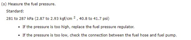

    Almost forgot:
    Torspd likes this.
