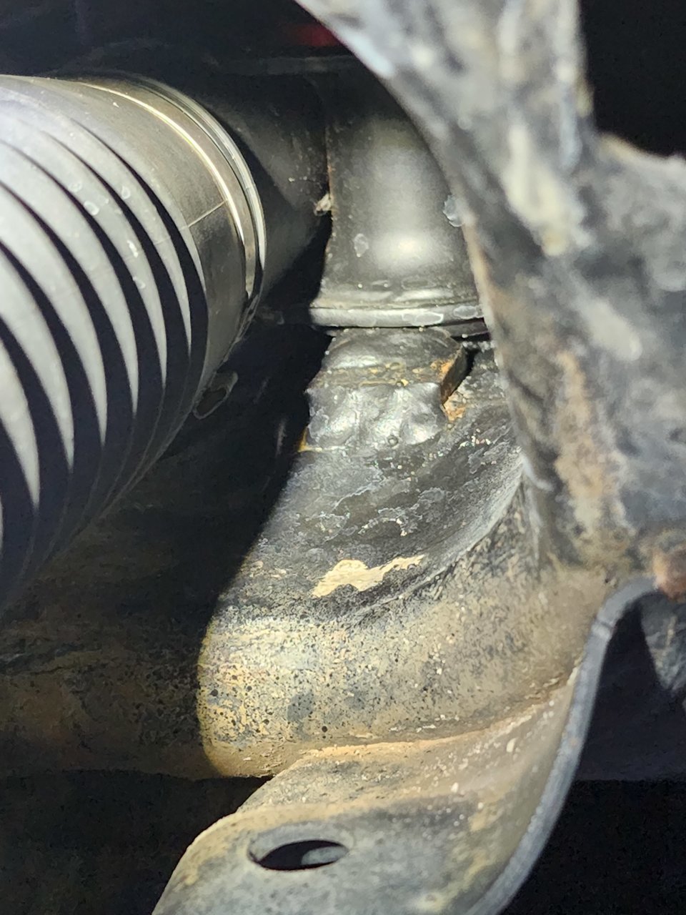

    Nice! Do you have pictures of the tabs? About to do this mod and curious if you were able to get it close-enough to the rack mount on the driver side without interfering with the hard power steering lines. Also worried about melting the bushings from the welding. Did you unbolt the rack the reattach after installing the tabs?

    I was able to unbolt the rack and prop it up with a 2x4 with everything still connected while I welded in the tabs. I did several tack welds as to not create too much heat. I'll try and upload a pic later

    Here's a pic of the tab I welded on the passenger side of the rack. I did the same on the drivers side 20230121_072706.jpg

    Looks great. Thanks for posting. Does that help the rack stay put as well or are you mainly worried about the bushings moving? In the video it seemed like the entire rack was shifting but maybe that is because the bushings were not tight?

    I was more worried about the rack since that's what was throwing off my steering. The bushings in the video were torqued down to specs.

    Nice. I went with a vertical tab since my 1/4" metal plate wasn't thick enough to stop the rack. Terrible terrible welds but they haven't moved yet and the rack is now solid enough. Great idea man, thanks for sharing.

    Yeah they should've put a 3rd mount on these jokers. Everytime I go hit the trails and hit a washout my steering went offcenter. Now it stays straight as arrow. I could've used two 1/4" tabs stacked on top each other but this seems to work great so far.
