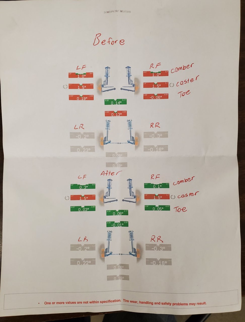

    I am having a similar problem. No one has been able to come up with a solution or the root problem. I have replaced all shocks and had an alignment. Here are my numbers. If anyone can help me out as well I would greatly appreciate it.
