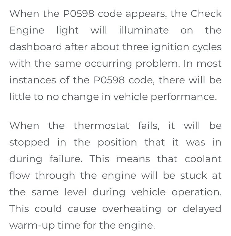

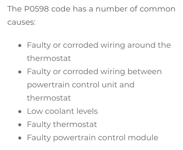

    3F2400DC-6150-40DC-9EF8-95A992064993.jpg 10AE166F-E66E-4491-9E4B-15B6D26A4992.jpg
    I would clear the code and see if it comes back in three ignition cycles would indicate a problem chances are you set the code pulling fuses with the ignition on and there is actually no problem at all.
