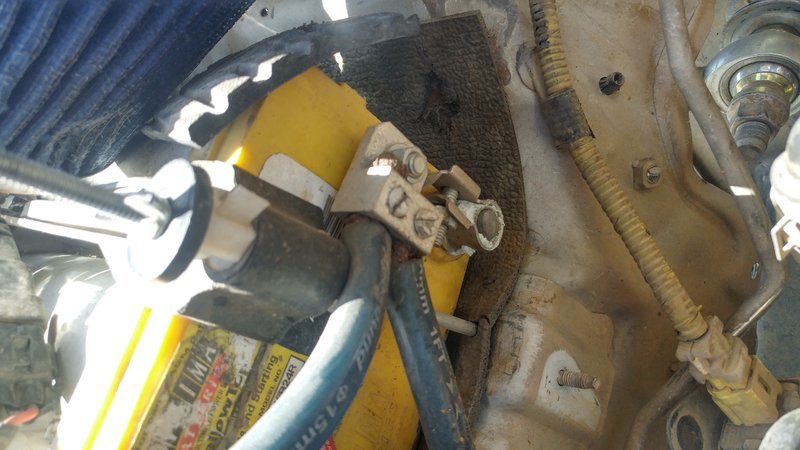

    Voltage regulator allowing something to drain the batteries when truck is off? Just a thought...

    Not pinched.. But some corrosion

    Corrosion on the terminal post of the battery.

    Do they have these stock ?

    Never mind see the corrosion on my phone now when I blow up the pic

    If you don't have a battery brush get one..trust me. That may not be your whole problem but it sure ain't gonna help

    Is that picture of the neg or positive. If pos., it could be shorting out on that threaded rod and shorting directly to the frame.

    Its the negative...

    Looks like someone pressed mashed potatoes into the terminal.
