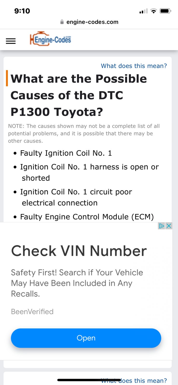

    P1300 came up after it would die, the charging light never came on only check engine, i replaced alternator, and battery, I replaced the positive terminal with a duralast one from autozone, the b terminal was not corroded but the plug in was, I soldered a new connection and new plug in, the alternator is reading that its charging my battery with 14.3 volts according to o reilys. What in the ignition could be going out? and no i dont know where to look for a ground. my clutch saftey sensor plug is broken so I will be replacing that.

    im going to get ignition coils and try that, if not then ecm

    I’m pretty sure a 96 3rz has distributor
    2.7L correct?
    if so, your looking at/for issues with the the cylinder closest to the radiator
    Plug/plug wire/distributor cap/D rotor

    yeah im gonna check my rotor cap in the morning or tonight, i just bought an ignition coil, so im gonna replace it tomorrow for sure and hope its that.
