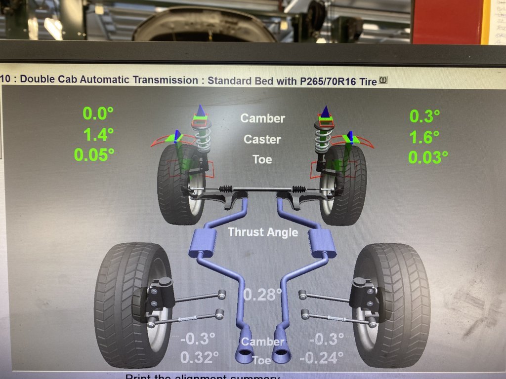

    Guys,
    Here's the numbers for the alignment I had completed today.
    Also, I understand tires, lift, etc. can/will alter how a vehicle handles, but the truck drove straight as an arrow prior to towing it across the country.
    The aftermarket suspension components were installed three years prior to this issue, so any relation is unlikely.
    I've been using the same size tires since removing the original tires back in 2012. I used one set of Duratracs (I don't recommend), three or four sets of KO2's, and currently a fresh set of KO3's. This issue started at the end of a set of KO2's, shortly thereafter I put on the Duratracs, and the KO3's went on in October. The symptoms haven't changed, so I'm highly confident this isn't tire-related.
    I have an understanding of how the camber, toe, and castor affect handling, but don't know near enough to estimate the effects based on the numbers shops provide. However, the truck has never pulled left or right. It still doesn't pull left or right... It just decides to dart one way or the other now and then.
    I live in Arizona, so rust/rot isn't an issue. I had it in New York for the one winter, so there's a negligible amount of surface rust in places (the amount where a couple swipes of a wire brush will take it off). I grew up in Massachusetts, so I know all about rust. I sold my 98 Tacoma back to Toyota when they did that buyback program back in 2008.
    I can't find anything loose underneath, but I did end up reading something where a guy couldn't find anything loose, but fixed a steering issue by replacing his steering shaft. Sounds like that may be the next logical thing to try? Or just take it in to have the steering rack replaced as well?

    The caster is entirely too low.
    should be closer to 4*
    Low Ranger, Kolter45 and essjay like this.

    No, toyota spec is usually 2-2.5 degrees on the trucks, its low, but not wildly low. Ideally 2 degrees of caster would be better. Lifted trucks need upper control arms to get above 2 degrees.
    I'd ask them to max caster and let the camber climb if you want better highway driving feel. Otherwise you'll need aftermarket upper arms.

    Those are factory numbers.
    These trucks get real floaty and wander when they’re lifted and the caster is low, just like the OP posted.
    ~4* of caster will “tighten” up the steering and you’ll lose that floaty feeling.
    Setting the cross caster properly will also elevate some wandering caused by the crown of the road.

    Yes but its impossible to get 4 degrees of caster factory arms.
    I did a truck today that maxed out at 2.6, also the higher the caster, the more the camber climbs.
    We rarely set to 4, even techs with SPC arms have reverted and settled with 3-3.5

    Right.
    That’s why it’s recommended to use aftermarket adjustable UCAs.
    The OP’s problem is the stock UCAs and lift.
    The truck is going to continue to wander like it is until the caster issue is corrected.
    Either add more positive camber in hopes you can get a little more caster out if the alignment cams.
    Or install adjustable UCAs and fine tune the alignment.
    Or lower the truck back down to stock height so it can be properly aligned.

    I don't doubt that increasing the caster could improve things (as mentioned, I'm not knowledgeable enough to equate the numbers to handling), but I'm told that's the best he could get. And while higher caster numbers may very well help handling, the current numbers appear to be really close to some historical numbers. The new camber numbers are lower, but I suspect that's due to all the new parts (though I don't have the numbers from 2020 until now to prove it). And with those settings, the truck handled great.
    The only "change" between great and awful was loading, towing, and unloading from the trailer. Absolutely nothing on the truck was modified in any way, shape, or form during that trip. And this wasn't a gradual "I feel something getting worse" sort of thing... It was an immediate change. And it hasn't gotten any worse or better since. I did notice it handles ever so slightly better with the tires aired down to 20ish psi (no, I don't regularly drive at that pressure).
    I've been convinced something was bent during the trip, but obviously not enough to notice by eye.
    Here are a few historical alignment numbers for which I still have paperwork:
    ***I doubt it matters, but the picture of the alignment screen has the wrong tire size. The truck's had LT265/75R16 tires since July/August of 2012.
