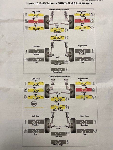

    Tag... my 2014 does the same thing. Will look at my last alignment sheet when I get home.

    Would appreciate input from those in the know. My 2014 has wandered for quite a while. Don't drive it much but it does bother me.
    This was the last alignment I had from a reputable shop. I can go back with specific directions is I have them.
    Before on top, after on bottom.

    ^^ You might want to ask them whether the alignment cams were siezed and take a look yourself to see if they bent or flattened the fences next to the eccentrics of the cams.
