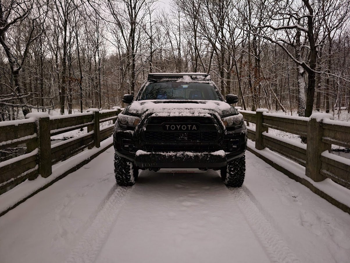

    All of these comments and replies are starting to scare me. So I've been driving manual transmissions for my whole driving life (20 years now) and currently both my truck and my summer fun car are manual transmissions. Never have had to replace a clutch to date and had my last manual car for over 140K miles and it still grabbed strong. With that said this is my first Truck 4x4 in manual transmission. I drive very conservatively and am a stickler when it comes to clutch slippage, I'd much rather stall my car than excessively slip the clutch.
    This year Chicagoland area got slammed with snow, much like many other areas in the country. There were a few times I had to put the truck into 4Hi to get unstuck from parking spaces (some back and forth) and also use 4Hi when I take it off into a field close to my house for some snow fun. I have only used 4lo twice when 4Hi failed to get me unstuck. With that said, there was this time I was stuck in a spot and I used 4Hi and the wheels spun a bit and when I got out I smelled a bit of burning. I tried to smell in the grill to see if it was coming from the engine area but it didn't smell like it was so I dismissed it to possibly the tire spinning on pavement or hard snow.
    Now I'm wondering, how much damage did I cause and does my clutch now have premature wear on it. Is using 4Hi really that bad in reverse on a manual and should I never do it again?
    Here is a video of the kind of snow I would deal with. This was likely the most snow I experienced and I tried 4Hi first (the first video is 4Hi and yes I stalled lol)
    https://photos.app.goo.gl/46Df2iTpwp8JyRD26
    this video is after 4Hi wasn't working and I went to 4Lo:
    https://photos.app.goo.gl/3ww9ftPhZKmd1grH9
    Here is a picture after I was done playing (I reversed to this bridge in 4Hi BTW)
