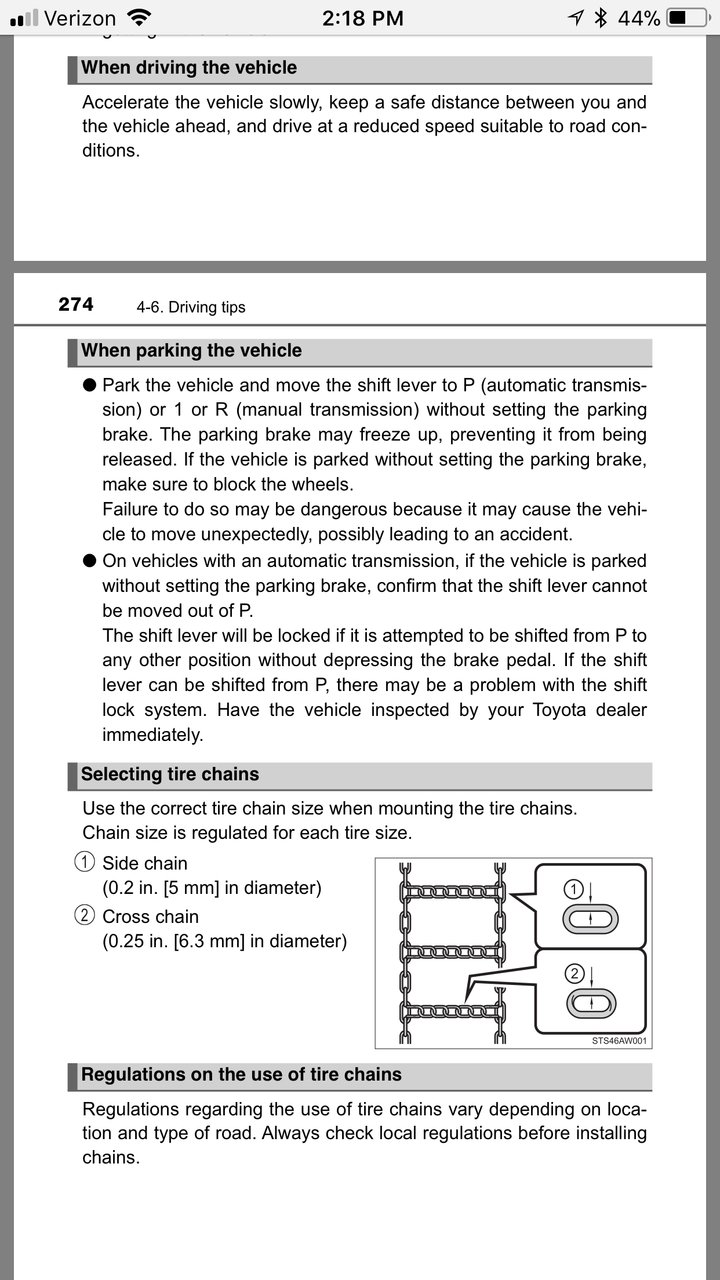

    If you go back to the other thread you're ranting in, look at post #29.
    https://www.tacomaworld.com/threads/frozen-e-brake.525447/
    Dwell and BillsSR5 like this.

    Keep reading that thread, it's also posted in the owners manual with a link posted.

    Sure enough, it is in the owners manual. But they provide no reference to this issue upon selling the truck, even in cold climate regions.
    They could have put disc brakes on these trucks long ago, but for the love of profit. That is what reputation does, allows them to sell less for more and not upgrade, while other manufacturers have to include a lot more on their vehicles to compete. Get famous and you can even become...ups..digressing...
    The service manager just called back. He has been doing it 19 years he said and did not know it was an issue or know it was in the manual until he talked to a regional guy about it after my call. And added that it appears to be happening more frequently with the new trucks.
    So mighty Toyota just washes their hands and sells you a truck with “USE AT YOUR OWN RISK” parking brakes and does not tell you about it when you buy it.

    Not to rain on your parade but you engage the parking brake on hot discs you're going to warp them. I have to remind myself of this on some of my other cars.
    Learn the risks on what you have, become familiar with the manual instead of just what the salesman says and you'll be fine.

    You have to be aware of "your" environment.. IE: if it's cold then warm then cold... and you drive thru 12" of H2O on the way home... Maybe setting the P brake is not the best option... Next time yes..!
    I live in a cold climate, and have NEVER had an issue with the P brake..... I use it every time I park the truck.. that way it is always functional.... Like when I might need it..!
    My neighbour never used his P brake and when he did need it (Brake fade).... I did not work as it was rusted to "rat shit"....!!

    It is in the owners manual that IS telling you about it. Your supposed to read that thing that’s why it’s there.
