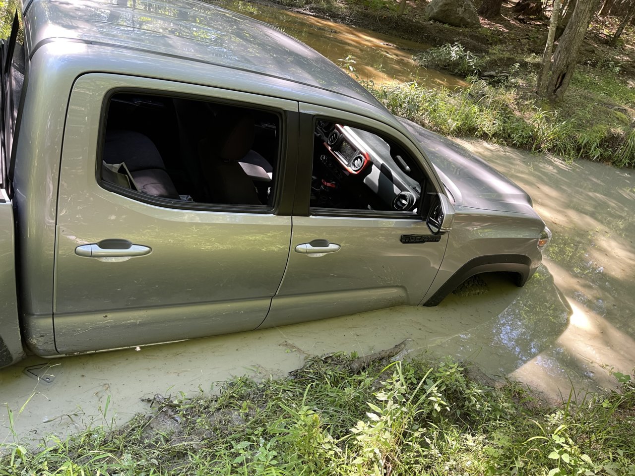

    Some of you may have seen my post yesterday, basically, I got stuck in a mud hole and I'm worried about damage. I am going to try and lay out the events as best as possible.
    • Yesterday I got stuck, the engine was running but I did not get any water in my engine, my air filter has a bit of dried mud in the case, but it's not wet or moist to any extent.
    • I was giving it gas trying to get out of the hole, starting and stopping the truck about 4 times trying different recovery methods (yes I know now that I shouldn't have done this)
    • After I got winched out, my truck would not start. When hitting the start button, all the electronics were rapidly flashing and clicking. I checked the engine and saw that the ground was loose, I tightened it and started up the truck with zero issues.
    • For the rest of the day, I drove it fine for about 20 miles, starting and stopping the truck another 3-4 times.
    • Today I go and start the truck, all of the lights and electronics work, and the headlights are on full brightness. I get a clicking noise and nothing from the engine. I got a buddy to jump me and it took about 5 minutes of the vehicles being connected to start.
    • The truck started right up, ran totally normal, with no stalling when starting. I drove for about 20 miles, stopped the truck and could not start it again without a jump.
    I'm assuming it's the alternator, but if that was the case then why did I start and stop my truck around 8 times with no issues? Could also be a fuse from the ground shorting? Not sure, going to take it to get tested tomorrow, but some early opinions would help. Thanks!
