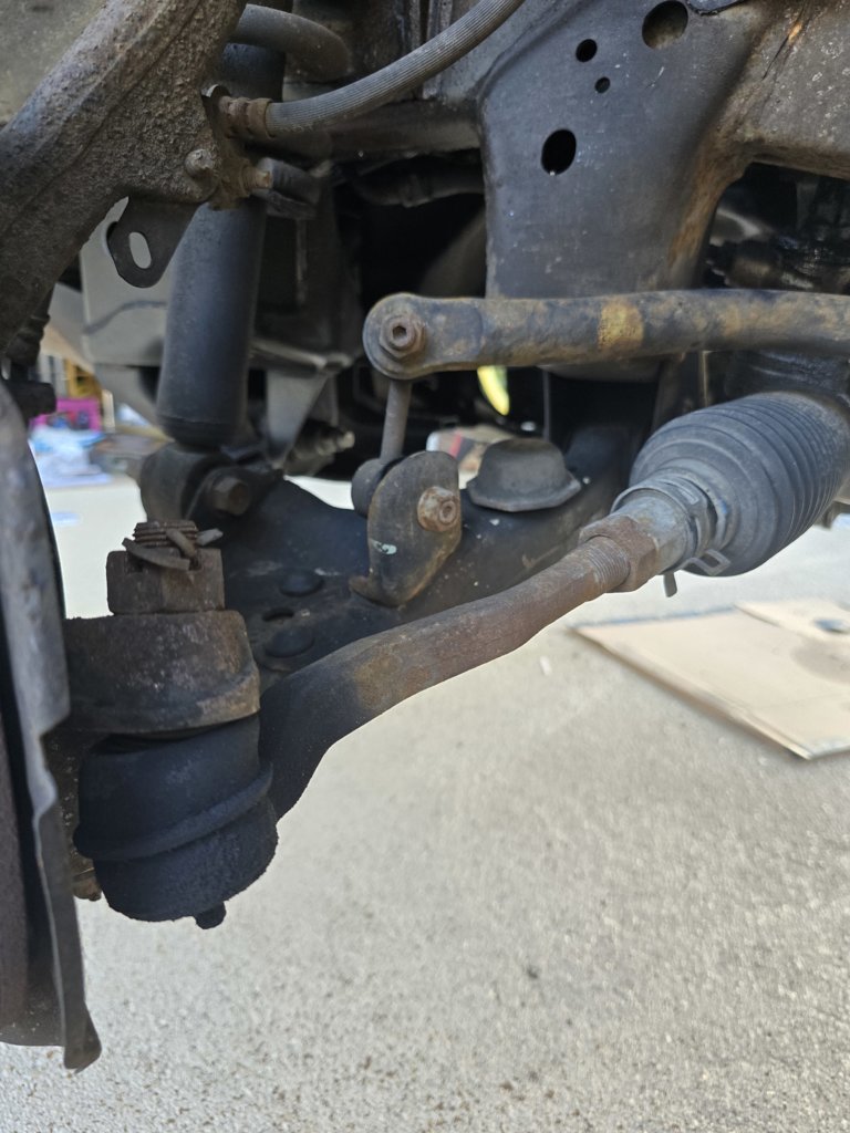

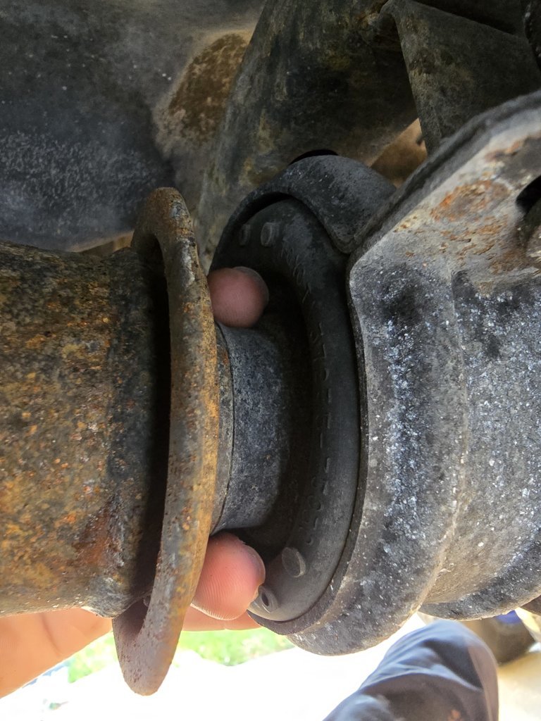

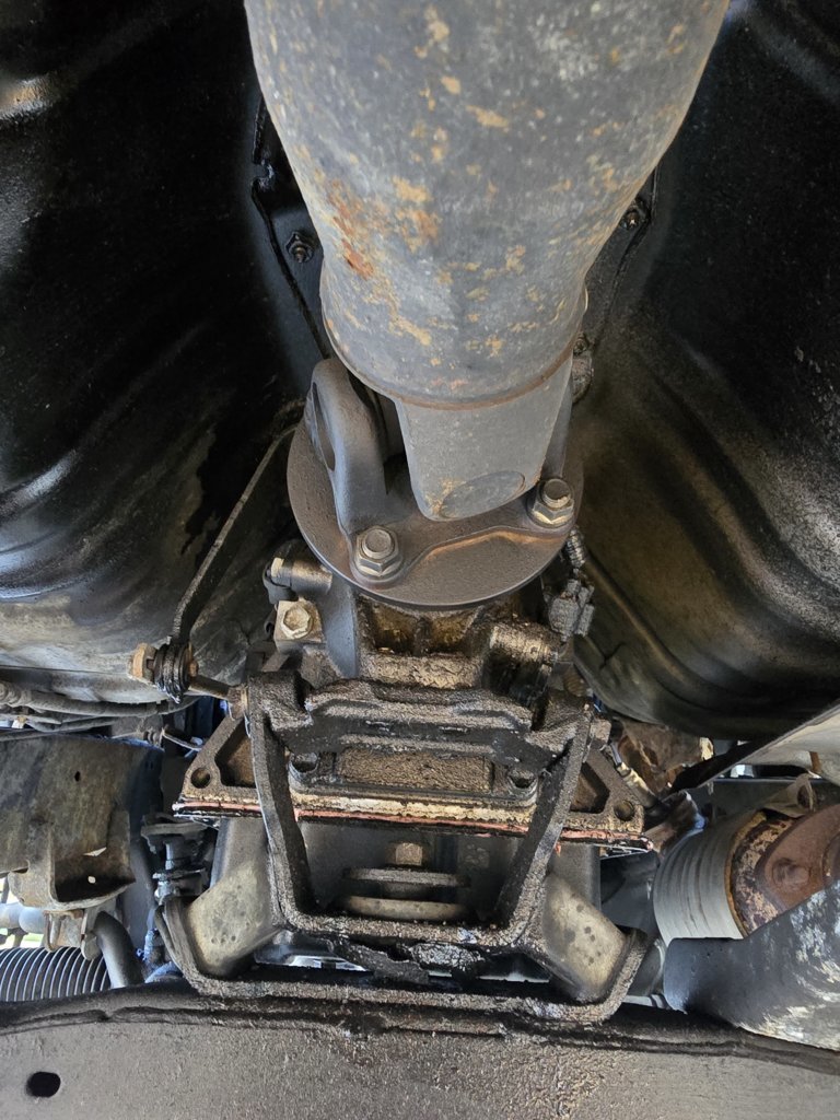

    So an update,
    The hub wheel bearings looks to me like a big pain in the butt to fix, and I have a bad front right wheel bearing, the bearing is not super bad but not good. I'll be looking to do both of the front wheel bearings. I'll need some Help on what all to get, I will be looking into this soon.
    Continuing with the right side I have what seems to be a very bad lower ball joint, a bad boot that has holes, the inner tie rod very bad, outer tie rod very bad, bushings on right shock bad and of course the bad wheel bearings. Probably more issues so I'll be replacing about every steering or suspension component/part in the front end of the vehicle.
    Left side was everything that the right had but not as bad as the right and the wheel bearings had no bad signs.
    Because so many steering components were bad, my power steering has a slow leak, the age/miles of my steering Rack, paying to get an alignment and other symptoms, I've decided it would be best for me to replace the rack as well as if it does have a problem I don't want it damaging what I just put on the Taco.
    I'll try to get some photos in of the current state of things.

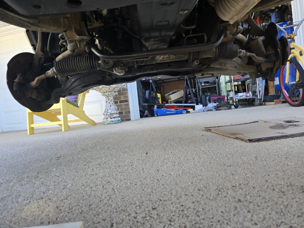

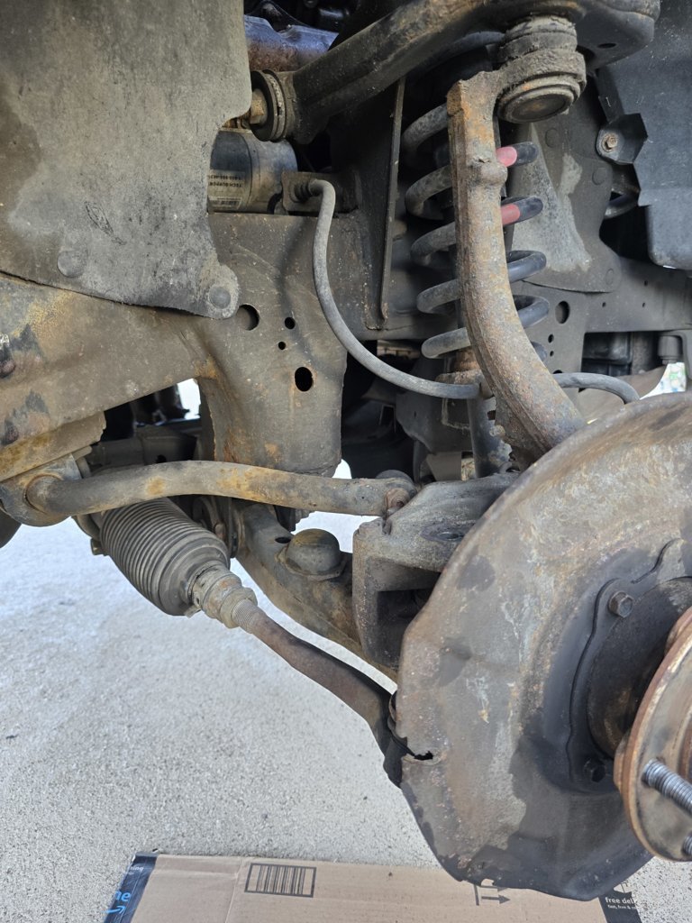

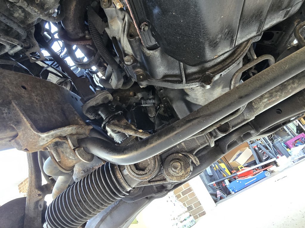

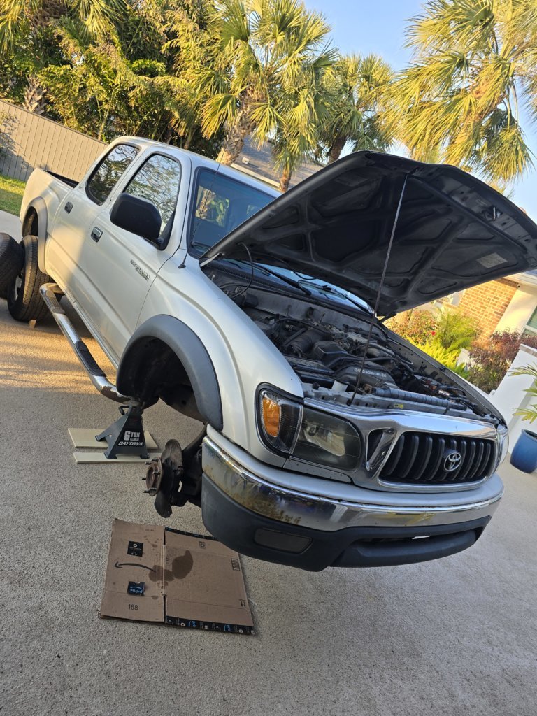

  15. Feb 11, 2025 at 2:52 PM
    Majestic Tacoma
    Majestic Tacoma [OP] Well-Known Member
    Dec 9, 2021
    #384194
    66
    Keiden
    2002 Tacoma PreRunner SR5
    There is the before in a week or two ill have the after.
    Looking forward to everything but the wheel bearing replacement.
    I've damn near exhausted my all of my current budget on this, need to file my taxes for some more truck money.
    Hopefully the truck will drive smooth as Tennessee whiskey.

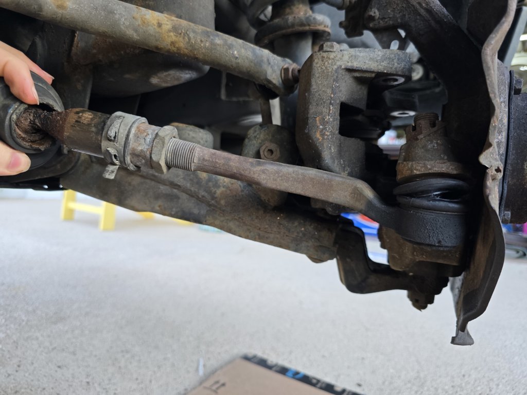

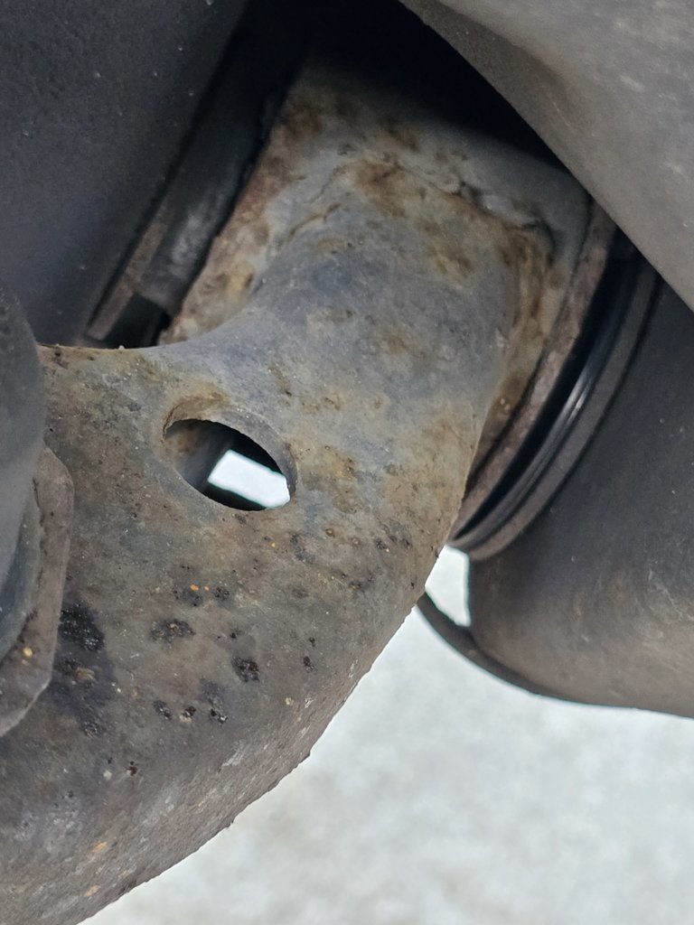

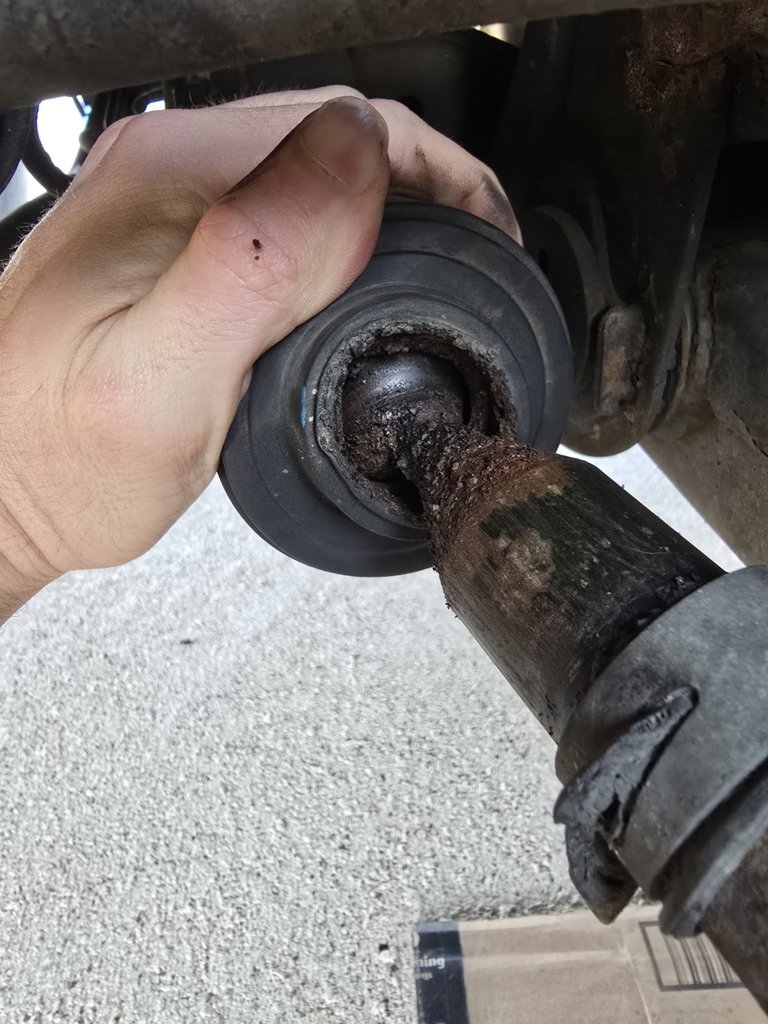

  16. Feb 12, 2025 at 9:57 AM
    #16
    skeezix
    skeezix Well-Known Member
    Oct 31, 2010
    #45512
    2,330
    Colorado
    1998 Limited
    Picture 7 - Prolly indicates that you should replace the outer tie rod. Also indicates that dirt may have contaminated and damaged the inner tie rod. I would check them for play.
  17. Feb 12, 2025 at 10:28 AM
    #17
    Majestic Tacoma
    Dec 9, 2021
    #384194
    66
    Keiden
    It has a lot of play like ALOT. After inspecting the front wheels steering and suspension parts I'm going to be replacing or rebuilding every part other than the sway bar->it will get new bushings.

  20. Feb 12, 2025 at 11:08 PM
    #20
    ControlCar
    ControlCar My Moto: Help & Learn…period.
    Jul 22, 2023
    #429578
    3,589
    Steven
    Sugar Land TX
    1996 Taco 2.4L 2wd Automatic
    Clock Volt meter/LSPV Delete/Hyundai 16’s/FP gauge/after 9months of wrenching ZERO oil leaks
    Good for you
    Getting dirty wrenching….getting up close and personal to your taco!!
    IMO
    Besides ball joints
    that steering rack/inner and outer tie rod look pretty shot
    Lemme guess your dad replaced tires more than once???
    im firm believer in Remanufactured racks
    now its a shop/vendor you’re looking for….not a online click thing
    typically these vendors RM both steering racks and CV axles
    ADCO is a national brand but lil expensive
    Look around, you will find one
    now the good part
    If you take your rack to one of these RM vendors…..typically $250/$300 1day turnaround
    They replace all inner rack seals/boots/inner tie rods
    You would only buy otr ties
    Now that’s me(2RM racks installed, one car sold one still running no leaks……shit that was 9yrs ago)
    GL
