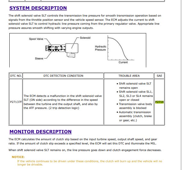

    You need to get a scanner that can perform active testing to check all your solenoids. SM states that you need to check SLT solenoid. Then go through the list outlined in the Trouble Area

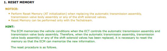

    @Twisted_Taco16, did you reset ECU and the tranny memory after the replacement?
