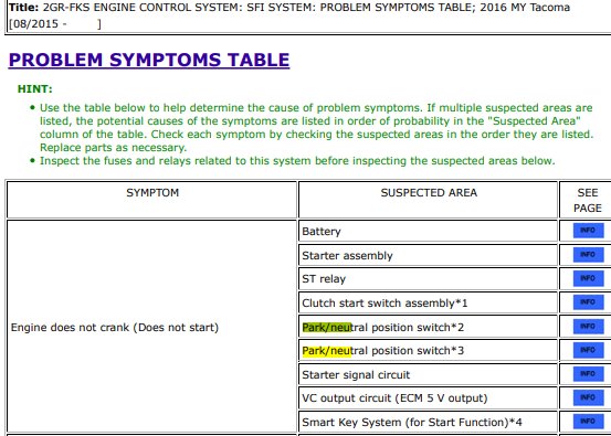

    @Seareef228 , are you AT or Manual?
    You probably messed up Park/Neutral switch and or have a short causing the issue with the voltage on CAN network
