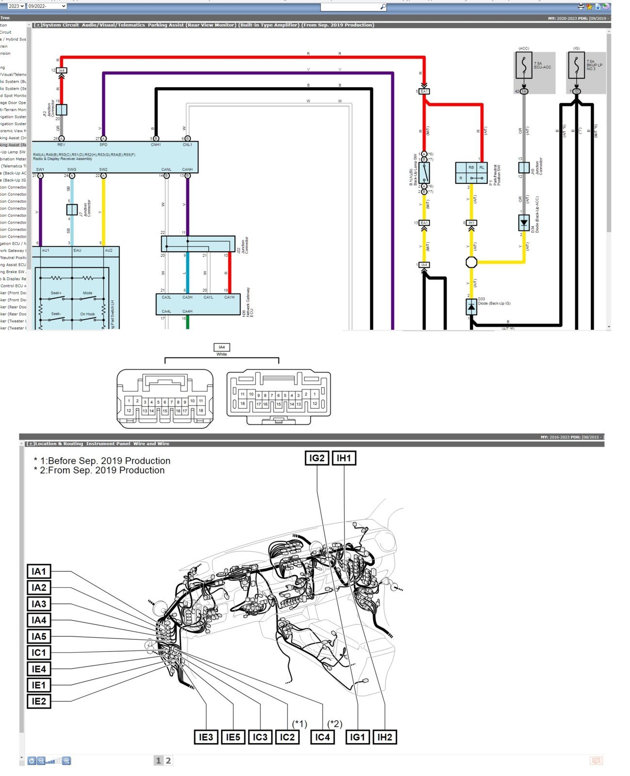

    Definitely, still need to find a reverse trigger wire , I know is one behind radio but there is also one behind kick panel , just didn't know which one , they changed from 18 to 23

    #72
    Dm93
    Dm93 Test Don't Guess
    Mar 3, 2015
    #150066
    13,714
    Texas
    2014 DC OR 6spd 4x4
    Predator tube steps, Ranch Hand grill guard, Magnaflow CatBack exhaust, Toyota tool box & bed mat, 2LO Module by @Up2NoGood, Rearview Compass/Temp Mirror, Tune by @JustDSM.
    IA4 Pin 12 (Red)
    Stevie17 and Superdave1.0 like this.
