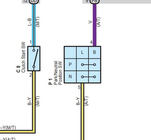

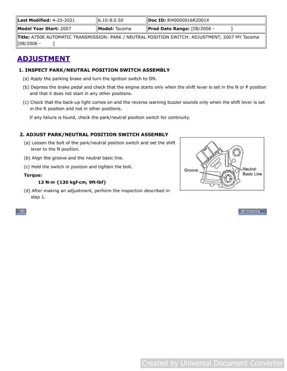

    Sounds like it's not adjusted properly or the switch is defective, the same circuit in the switch is used in both park and neutral to start the truck.

    It can’t be ANYTHING else? It happened before, and I replaced it with new OEM. Took great pains to adjust properly as well. And it does show “N” on the dash when the shifter is in the neutral detent

    I'm not seeing how unless there's something not OEM wired in somewhere that is preventing it.
    Check continuity between pins 4 and 5 of the switch in both park and neutral, that will tell you if it's the switch or not.

    The “N” on the dash doesn’t directly correlate to the N for starting.
    They don’t share the same path, I asked my question above because it would give us an “idea” if the switch was timed properly.
    Here is what I’d do, put it in Neutral.
    Hold the key in the crank position and rock the shifter slightly forward and backwards to see if you can get it to crank. Again, do this in Neutral.
    If it wants to start, you can try retiming the switch.

    Hot damn, TnShooter! That was a good idea. It did start halfway between N and R. So I’ll have to sort of clock the switch backwards and misalign the line and groove contrary to what the FSM says.
    I’m the second owner. When I removed the old switch, I noticed that the shaft the switch rides on was gouged, so someone was there before… and didn’t do a very good job removing the switch…
