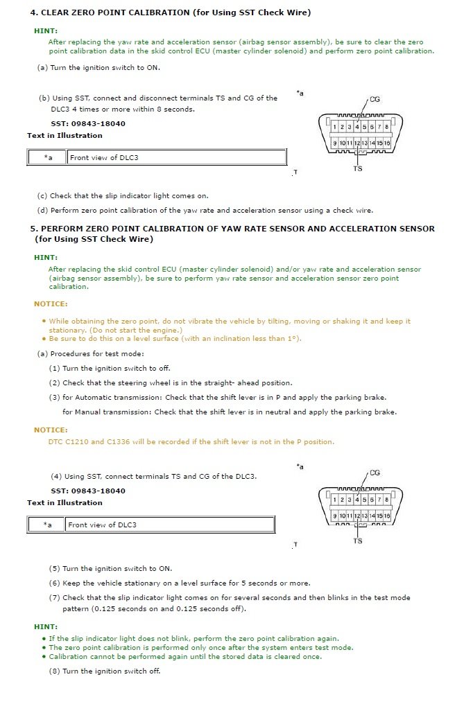

    ABS is a light.
    VSC is a buzzer.
    Have you had an alignment and done the vsc/zero point steering recalibration?
    Speed sensors okay?
