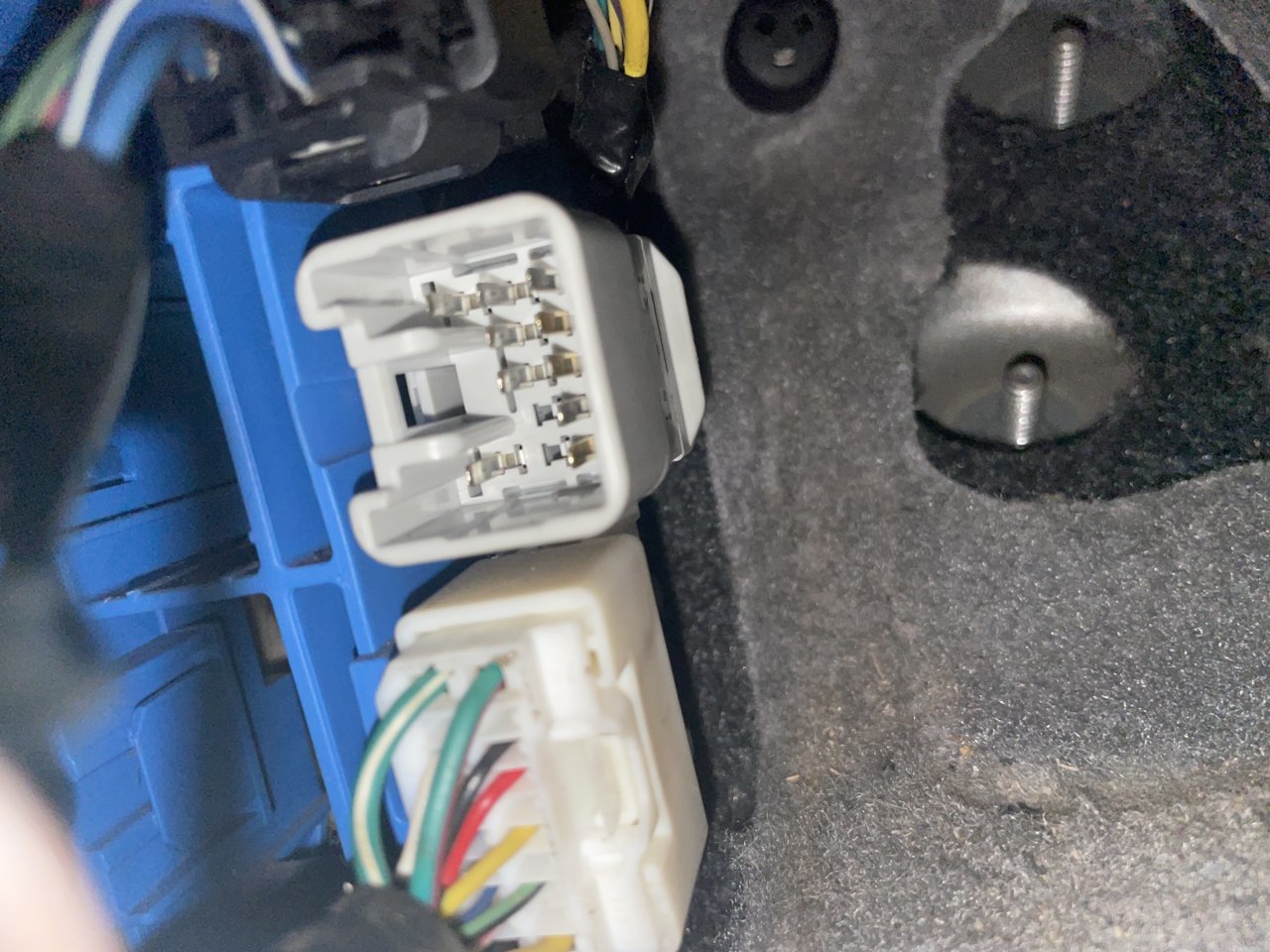

    Upon using my multimeter to check for current through one of the wires on my truck, my truck turned itself off and now won’t turn over. I was double checking to see if the reverse signal wire was the one I thought it to be so I put my truck in reverse and was trying to see if I saw current go through the terminal I thought it to be. As soon as I put my multimeter to it, my truck turned off. I though I blew a fuse but after inspecting all of the ones underneath the driver side kick panel and the ones underneath the hood, no luck. Yes my battery is good and it’s terminals are clean. Any wild guess at what I did? When I try to turn over my truck, the ignition won’t go off.

    Side note: the taco is receiving power to all the lights, radio, etc as normal. Battery is putting out what it should, confirmed with the multimeter.

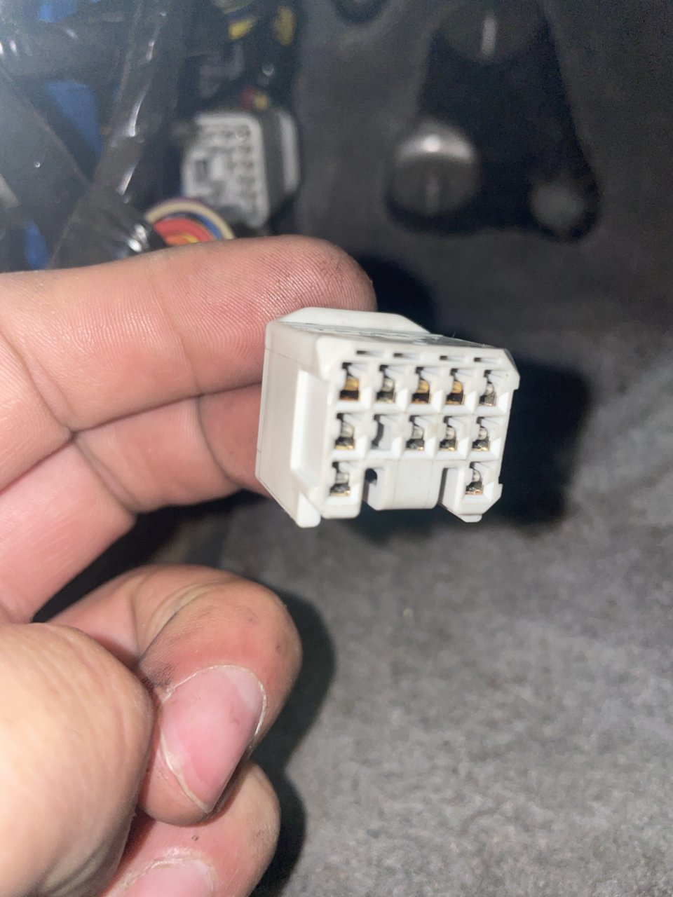

    I put my meter to check for 20v when it turned off. The way I checked it was putting one end to one of the pins and another to a part of the truck which was bare metal (ground). I checked the fuses twice for continuity. I’ll double check for ohms.

    That's the proper procedure; I'm guessing a likely scenario is that you inadvertently touched a second pin and shorted it to ground/power. When trouble-shooting like this, the right equipment is critical. The best solution is to either use a backprobe, or a front connector to avoid jumping pins in the harness. Failing that, get a ground lead for you meter with a clip on it, so that you can use both hands to keep the positive probe where it needs to be.

    Ok - that would be correct for voltage. When you said you were checking for current in the first post, I was wondering if you disconnected the connector while trying to check for current. Like tirediron stated, it's safer to back probe any connector rather than from the front/face, especially if doing male ends. With female ends, it's easy enough to avoid shorting across receptacles. Plus by using back probing, the connector can stay intact (connected) which, depending on what you're checking, may be preferable.

    yeah this was most likely the situation now thinking about it. It still leads the general solution to be “check the fuses” but I have. I did find this post and tak1313’s useful as I’ll keep that in mind for future testing. I’m used to working on 120-277v so the little plastic pieces on the tips of my meter are long gone .
    For those telling me that a visual inspection of fuses is “not good enough”, I know. When I say I tested for continuity, it means I used my multimeter to see if the fuse was blown or not. In terms of blown fuses, I have none. I will however check the amps.
    The truck is still not running but with the information given now, it should at least narrow it down a bit. I was working on the female end.

    Hard to short across multiple female terminals....
    . Not to beat the fuse thing to death, but did you check the J case fuses as well? If you bypass the solenoid, will the starter turn over?
