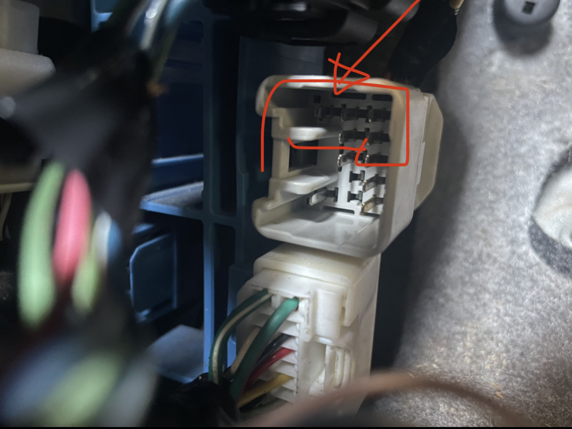

    Here’s a picture of where my probes were. I was trying to hit the prong where the arrow is located (which I believe is the reverse signal wire). The box outlined in red is what I believe could have shorted with.

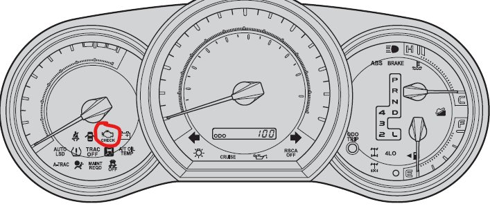

    Does the check engine light come on when you turn the ignition on?

    Tacoma Mike has a great question because if the CEL is not coming on/flickering at attempted startup, it's NOT good news.

    I can't tell - the cluster is too blurry and the phone moves all over the place. I don't have access to my truck right now, but here's an image from the manual (which I keep on my computer). Mine is a 2013 4 banger, but it should be the same - someone else with the exact year/version should be able to chime in if not. It LOOKS like it's not - it LOOKS like the battery light to the right, then an empty space, then the door warning?

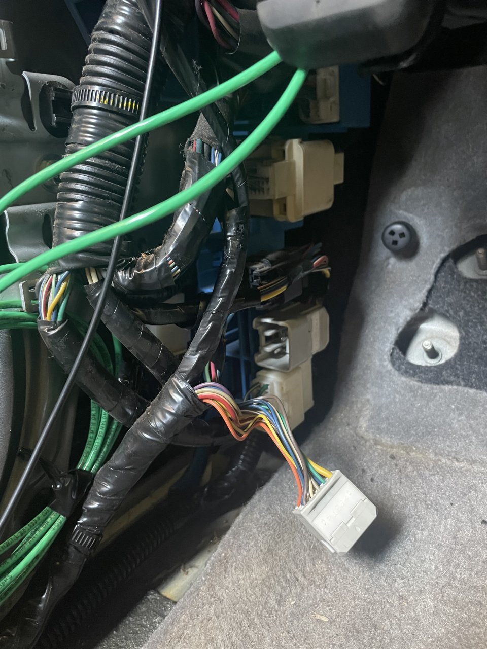

    dumb question...... did you plug it back in?
    wilcam47 likes this.

    And even if you did, it might be worth taking it back apart and making sure none of the male pins got bent.

    That looks to be the ID2 Connector in the drivers kick panel and the wire you were checking looks to be the red-white wire going to the Reverse Backup Lights.
    Look at the IG1 Fuse very carefully. I think it is blown.
