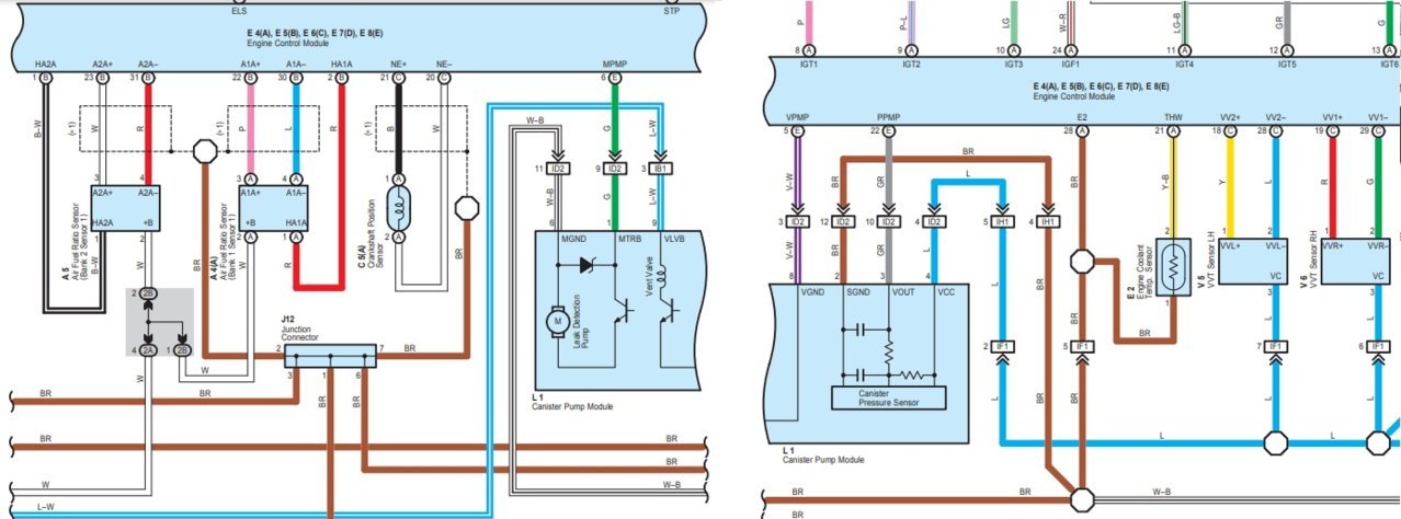

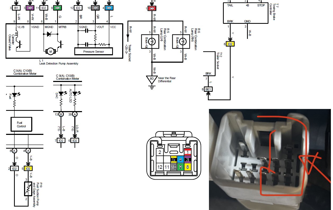

    I hate to say it but there is the possibility that something in the ECM got fried, all the wires for the leak detection pump are in that connector if it's indeed the ID2 connector.

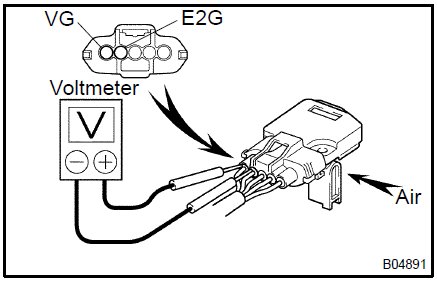

    I think I would start with checking if you have 5v Ref on the VC circuit.

    Go back to the check engine light. Does it light when you put the ignition on/crank like Tacoma Mike asked. Your vid was just too blurry and shaky. If it's NOT, you're not going to get anywhere because the bottom line is that something is wrong with either power to the ECM or the ECM itself is fried.
    Do as Dm93 said and check any 5v circuit (or multiple). If no 5v, your ECM isn't working.
