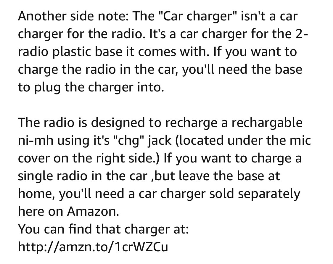

    We figured it out. Read the end of my post just before yours.
    BearWithMe and zoo truck[QUOTED] like this.

    The charger or the radios are/were sending out a radio frequency that caused the truck to think there was a key in it.... In 28ish years of fixing Euro Trash Cars (it's a good living, that shit is broken 24/7) for a living I've seen similar thing happen more than once.

    That's so weird. The radios were switched off the whole time they charged.

    I had the problem over several days in the summer and realized the solution entirely by accident. In my case I was charging a portable cellphone battery pack for charging my phone while I was on a back country trip. I had thought that the battery pack was feeding power back to the adaptor and the truck when the truck was shut off and that was what was causing the problem. I hadn’t considered radio interference.

    The radios are great. Just don't expect your locks to work if you charge them in the truck. Ha. I rarely need to do this anyway.

    Frequency interference...what band (Hz) are these radios?

    It's strange that the 2 radio base would come with a seperate 12v cigarette lighter style cord to use and not be intended for car charging. You're right, though. Each handheld radio has a small port on the side that's labeled mic/chg
