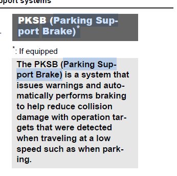

    Need to temporarily disable PKSB in settings.
    I think selecting "TWO HAUL" mode on the mode switch will work also.

    I think everyone else has already answered your question but I’ll add that the Owners Manual is a good resource. This topic is detailed starting about page 335.

    The tailgate camera is part of the collision avoidance system too.
    I was hauling some tree limbs and one of the limbs was blocking the camera. When into full brake mode.
    I turned that feature off.
