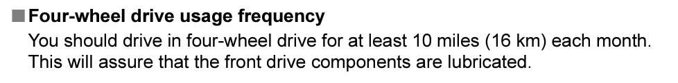

    I actually go through the whole four-wheel system and actuate it at least once sometimes twice a month. Exercise the actuators.

    I do the same yes, per manual.

    Yeah I always thought every vehicle you buy comes with a manual. I don't think anyone reads it though.

    I did not know this was even covered in the manual!
