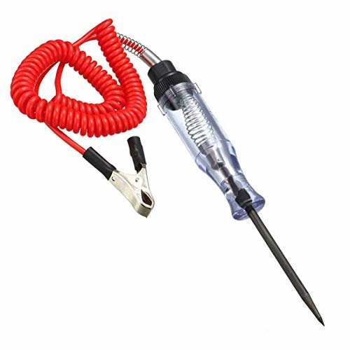

    Check all fuses with something like this:

    I agree with your ignition switch theory but you need a test light to check the wiring and fuses to the ignition switch before you replace the actual switch
