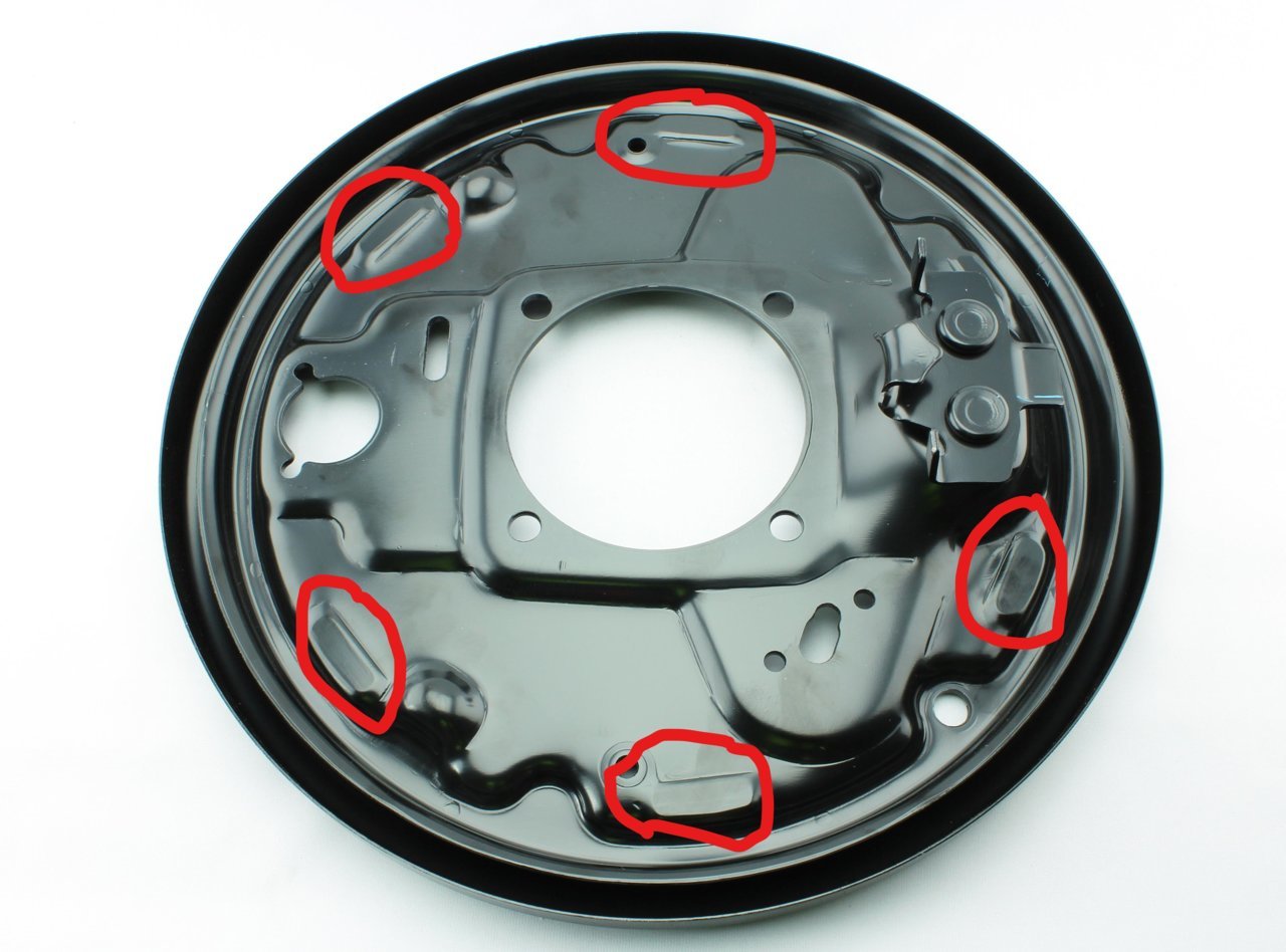

    Apply a thin film of brake grease on the raised pad areas of the backing plate. Problem solved.
    MGMDesertTaco and tacotoe like this.

    My drums almost always seize up temporarily after washing. Lately it hasn't been as bad as in the past. Before I could practically floor the gas in drive and reverse and the truck wouldn't budge. Now it breaks free without much hesitation. Drums need to be cleaned and greased at their contact points as part of regular maintenance. Yours are probably due for a cleaning, lube and possible adjustment.
    Edit: I'll add it's not the parking brake sticking. I've parked the truck overnight after washing with and without the parking brake engaged. I'm almost certain it's the side of the drum shoes sticking (rusting) to the contact points on the back of the drum plate. So, grease those contact points to minimize the problem.
