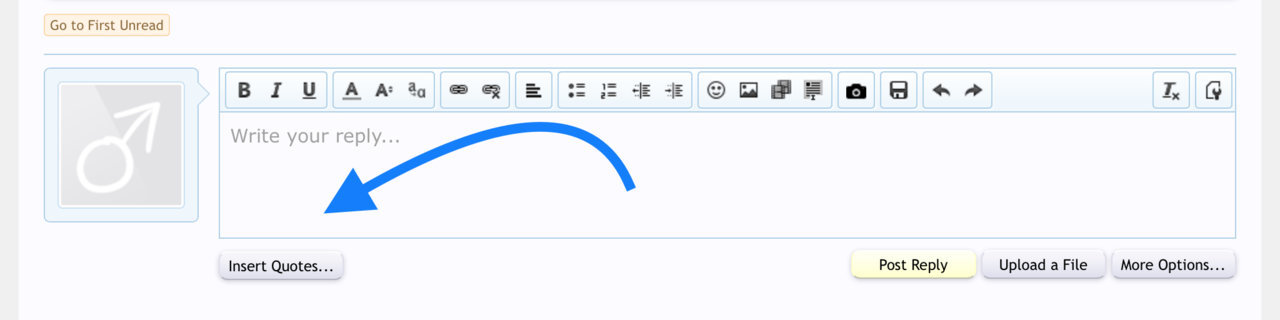

    OP, If you click Multi-Quote. You can replay to multiple people in one post.
    It will save some time, and help cut down on the read time for other.
    That way they can help you faster.
