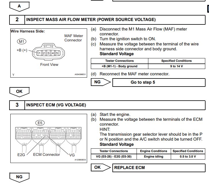

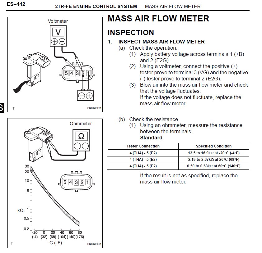

    Ok so I've bought a multimeter to even see if the thing is getting power any ideas on how to test it because there's no way to put it in the connector and I'd hate to cut it open just for there to be nothing wrong but I have no idea another way to check power to the sensor soon tomorrow I should be able to get the scan tool to get further data
  11. May 13, 2022 at 8:58 PM
    6 gearT444E
    6 gearT444E Certified Electron Pusher
    Feb 3, 2018
    #243372
    7,798
    Deep South
    Herculiner Hootus
    the FSM has expected voltage readings for given flows. Measure at the ECM for closed loop real time feedback.
    TnShooter likes this.

    Ok what color wires would I measure and how would I measure them with the meter sorry for all the questions but electrical stuff engine wise is not my strong suit and I'm trying to get as much info as possible before taking to the dealer so I can tell them what I know instead of them just throwing parts at it like some I know do

    Given you have multiple MILs for the same device (MAF), it sounds like a bad connection either ground or +B to the MAF, or the MAF itself is just toast.
