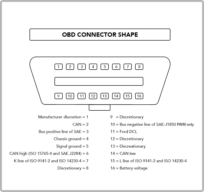

    Sounds like the CAN Bus is offline, make sure there is nothing pinched or shorted together behind the radio.
    Maybe even unplug the radio and see if things come back.
    If not then we will need to unhook the battery and check resistance between pins 6 and 14 at the DLC, it should be 60 ohms +/- 2 ohms.

    2016 SR5
    Disconnected OEM radio and no start with neither radio installed.
    pins 6 and 14 show 59.7

    Check them to pin 4 and pin 16.

    I meant check resistance between 6 or 14 and pin 4 and then pin 16 with the battery unhooked.
  14. May 23, 2024 at 6:00 PM
    psvines
    psvines [OP] Well-Known Member
    Dec 23, 2015
    #172961
    216
    2016 SR5
    Ok, battery unhooked
    4 6 .58
    4 14 .6
    16 6 5.9
    16 14 5.8

    Is that ohms, K-ohms, or M-ohms?

    Looks like multimeter defaults to M-ohms, though I didn’t retake samples.

    Just trying to make sure because if that's in ohms that would be a short.
    Check the voltage between 6 and 14 and then between 14 and 4 with the battery hooked up and the key on, also see if your CEL is on with the key on.
