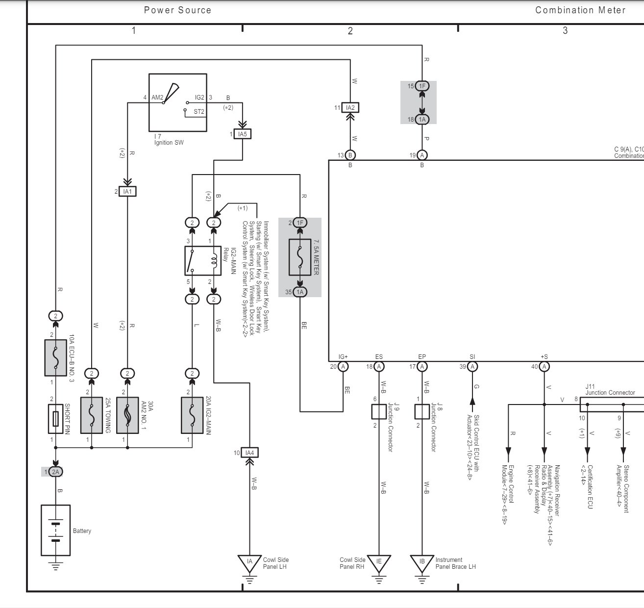

    I have about 30 mins before I have to leave the house.
    If I can't get back to you. The diagram below should be of help (or at least to Dm93). I will get back to you. I promise, but It's will a couple hours.
    I think we are 75% of the way to solving this now.
    Stevie17, jmneill and Dm93 like this.

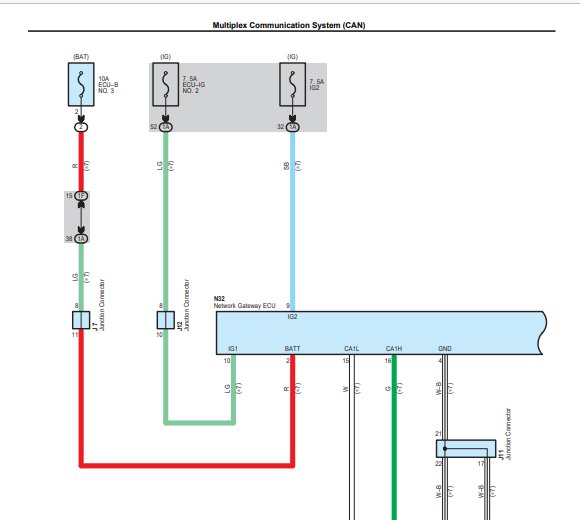

    It seems you took down CAN. Either via short in Main Body ECU or some modules are offline.
    Recheck ECU-B fuses. Use a good known one. Are you sure it did not accidently unplug any connectors behind the radio that does not belong to the radio? There are some junction connectors for CAN.
    Also these

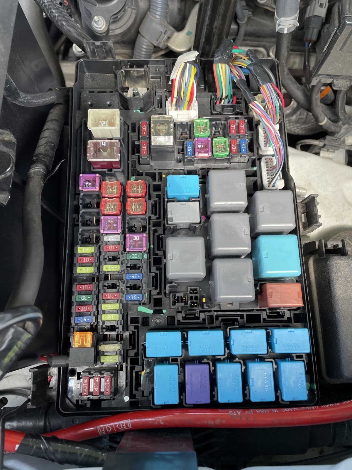

    Does your fuse box under the hood look like mine or is anything different? I would take the negative off the battery and start checking relays for a burnt spot .

    looks the same.
    How are relays tested?
