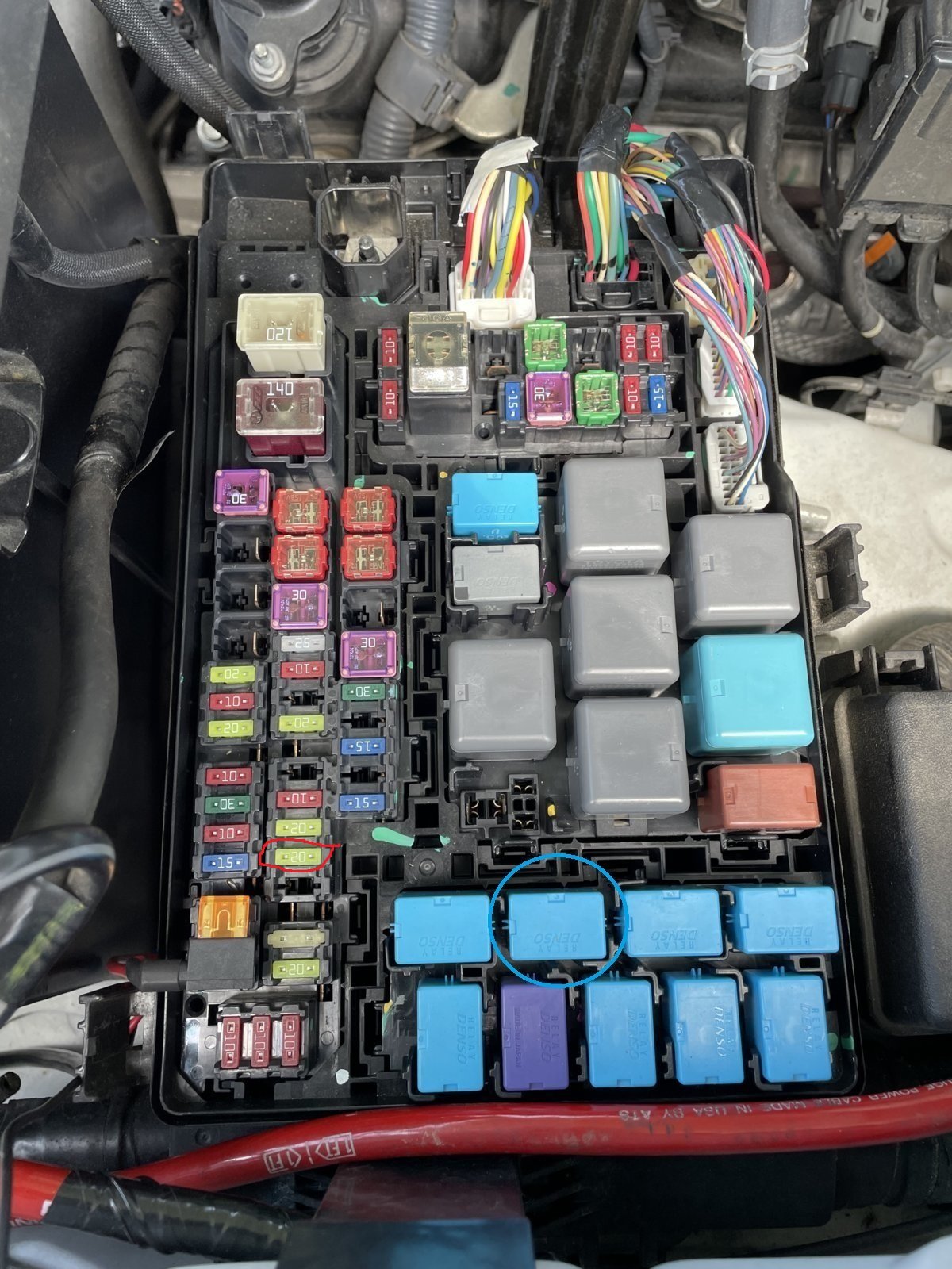

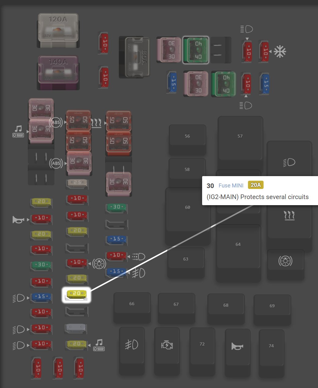

    OP the fuse is the IG2 MAIN fuse.
    make sure you check the right one.
    mit88, Stevie17 and Dm93 like this.
  7. May 24, 2024 at 7:17 PM
    #107
    Dm93
    Dm93 Test Don't Guess
    Mar 3, 2015
    #150066
    13,886
    Texas
    2014 DC OR 6spd 4x4
    Predator tube steps, Ranch Hand grill guard, Magnaflow CatBack exhaust, Toyota tool box & bed mat, 2LO Module by @Up2NoGood, Rearview Compass/Temp Mirror, Tune by @JustDSM.
    For notation it's the one circled in red.
    mit88, Stevie17 and TnShooter[QUOTED] like this.

    This pic of the fuses certainly helped get it started!!!!!!!!!!
    I'm exhausted and not sure about a few things.
    So there is NO Radio No. 2 fuse? Or this is literally for a 2nd radio so we don't typically have the fuse?
    Somehow in my testing of fuses early on, I must have put the IG2 Main fuse into the Radio No. 2 slot. So for the past day IG2 was empty.
    I think what happened:
    New radio didn't work.
    I first checked radio fuses, but accidentally pulled IG2, then returned it to Radio 2 slot. So in my mind both radio fuses were good. My check was simply continuity.
    I then checked all the harnesses and found the loose plug, and reinserted it.
    At this point, truck wouldn't start.
    Duh, I guess I had moved IG2 fuse in my radio fuse checks.
    Wow do I feel like an idiot, but hopefully lots of thread readers have learned from this episode.
    Now I get to install my new head unit again.
    @Dm93 and @TnShooter were fantastic in their research and suggestions.

    Well it was an easy fix as I suspected, just took us awhile to get there.:thumbsup:
    Radio No 2 and Radio No 3 are for trucks that have the JBL sound system, they power the Radio Amplifier. Not used on trucks without JBL Audio.
    Well the good thing is you learned how to check fuses in circuit instead of pulling them which as you found out can end up with them installed back in the wrong slot.
