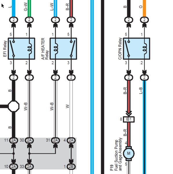

    2012 Prerunner SR5
    So if I read this correctly you have no relay in the C/OPN Slot?
    You need a relay in that slot as that is what powers the fuel pump. also check the EFI Fuse 20 ampere and the IGN fuse 15 ampere.

    I have no relay on the C/OPN Relay; there wasn't one there before. Can someone take a look at their fuse box and see if there is a relay there?

    So this got me thinking, I suppose I really blanked out and moved the C/OPN relay over instead of the TOW one. I moved the TOW one over to the C/OPN open slot and it started!

    Glad I could assist.
    As you can see in the print I provided above without a C/OPN relay the fuel pump will not run.
