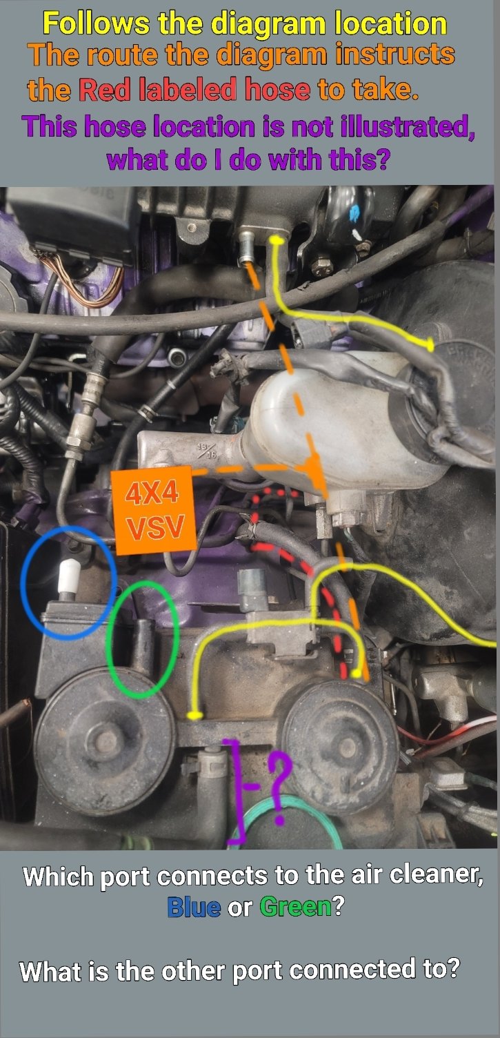

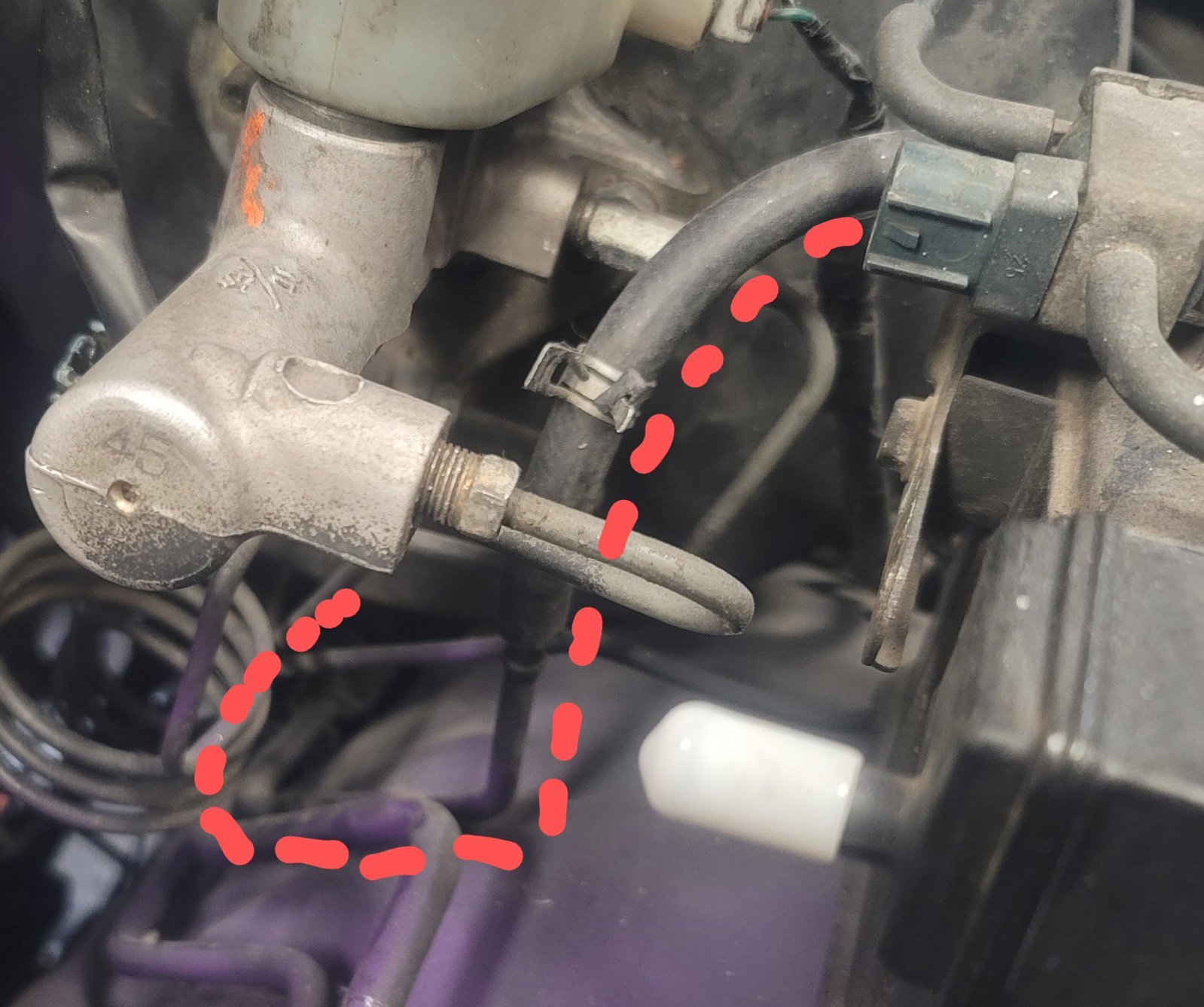

    I will check the IAC. Its fairly new. Which is why I ruled it out. I'm suspecting a vacuum leak. What's everyone's take on the pic attached. It's the driver side of my engine bay. Screenshot_20240423_001416_Sketchbook.jpg

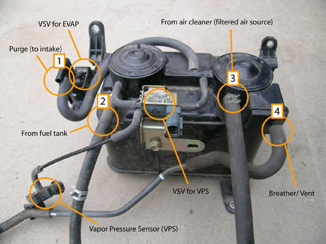

    #3 is filtered air coming in.
    #4 and vsv for 'vapor press sensor' vent off to atmos.

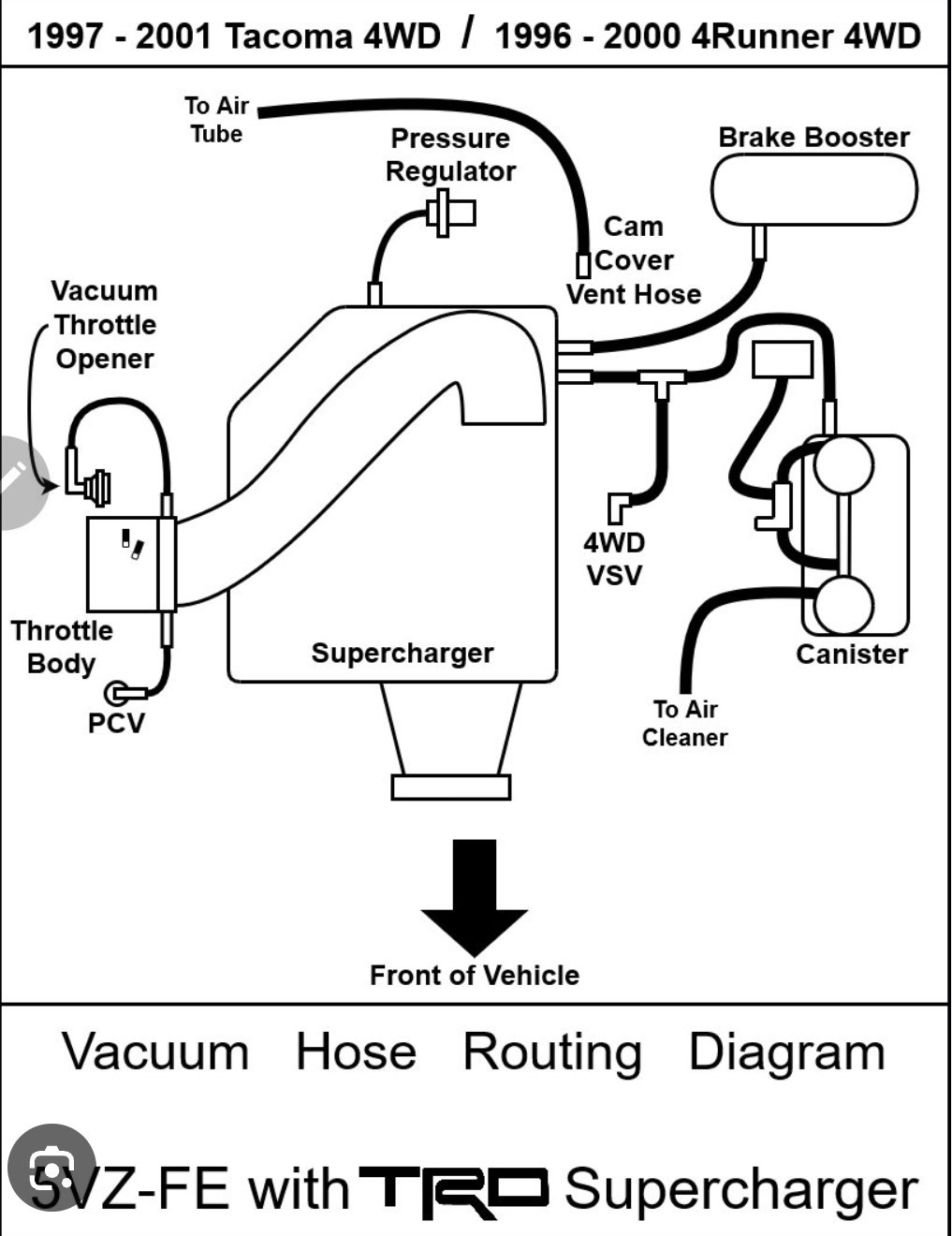

    When you say rpms shoot up, is it shooting to a "normal" cold idle like 1500-1800? Or does it rev even higher?
    Iac issues, in my experience, have caused a surging (jumping from ~500-1000 rpm) idle. With the supercharger diagram there id also check the vacuum throttle opener while youre checking resistances of the iac, e throttle motor, and throttle position sensor. Ive never worked on a supercharged 5vz. Very curious as to whats going on.

    Thanks for the diagram. However I need to know what some of those are in relation to the supercharger diagram.
