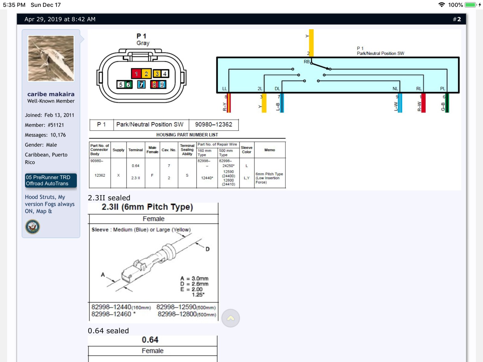

    Sounds like an issue with the connector at the switch, the switch itself (or it's not adjusted properly), or a wiring issue.
    Is there corrosion in the connector?
    Will it crank in neutral?
    You can check all the signals except the starting circuit from the switch backprobing connector PB on the junction box behind the glovebox.
    Each pin should be at battery voltage with the shifter in the respective position, the rest should be at or near 0v.
    Pin 5 (Green/Black) Park
    Pin 6 (Red/White) Reverse
    Pin 8 (Blue/White) Neutral
    Pin 3 (Blue/Black) D & 4
    Pin 1 (Yellow) 3
    Pin 7 (Red/Yellow) 2 & 1
    The Neutral Safety Switch portion of the range switch is Pins 4 (Violet) (Power in from the STA Fuse (7.5A) and 5 (Black/Yellow) (Power out to the STA Relay) at the switch connector.

    Thanks DM ....There is no corrosion on the face of the female plug to the PN switch. Also sprayed contact cleaner before Plugging it into you PN switch.
    Replaced PN switch very carefully and believe it is installed correctly...it is an OEM part so not very likely its defective.
    Will not crank in any shifter position
    Been reading for hours....now I’m thinking it might be loose wires inside female connection???
    Not very Electrically inclined .....can check voltage at the plug with basic voltmeter if you can explain how to do it and what voltage to look for .

    It's certainly possible it's a pin fitment issue, you haven't been poking things into the pins to check/clean them have you?
    I can try, remember you don't want to shove anything into the pins. All you need to do is touch the metal part of the pin with your test lead.
    At the range switch connector Pin 2 (Yellow) should have power with the key on (since some of your indicator lights work I have to assume this is good), Pin 4 (Violet) should have power with the key in the crank position.

    Thank you for your guidance ....
    Have not done any electrical test yet.... and I did not use any instruments on connectors.
    My theories have been simply going by symptoms.
    I don’t think it matters which lead you touch to connector ..... and I guess touch the other lead to a ground ?
    Am I looking for 12 volts ?
    I will be using The attached diagram of the face of the connector

    On the 2 wires I listed above yes, to check the rest you would have to be backprobing the connector with it plugged in.
    If you have a helper you can wiggle the connector while they watch the indicator lights and see if they flicker or light up.

    Couple quick questions.....to back probe....you stick the volt meter lead along side the wire into the back of the connector and other lead to ground ...correct?.......don’t want to do any damage !!
    Or should I pull glove box and check per your picture ? Or both .....Looks easier behind glovebox !!

    I would use a small sewing needle or backprobe, other option is a wire piercing tool but if you do that make sure you seal the hole with nail polish or liquid tape.
    You can but based on the symptoms and history we can assume what you will find at the connector behind the glovebox but you certainly can check it there.
    You could temporarily jump pins 4 and 5 with a small piece of wire and see if the truck cranks.

    What we found so far ...... when we jiggle wiring harness neutral light on dash flashes on and off ......
    Park indicator never illuminates nor does 2 or L..... all others illuminate corresponding to position of gearshift .....pin 2 has 12v.... was unable to check further because voltmeter died !!
    Also .... looks like no need for further testing because I think I need a all new wiring harness ..... do you know where I can find a part number ?

    “You could temporarily jump pins 4 and 5 with a small piece of wire and see if the truck cranks.”
    Do you do this at the connector of the range sensor switch ?
    It would be immensely helpful if I could get the truck started to move it around so I could fix it !!
    The pins in/for that connector are the size of needles...... do you have any suggestions on what to use ?
