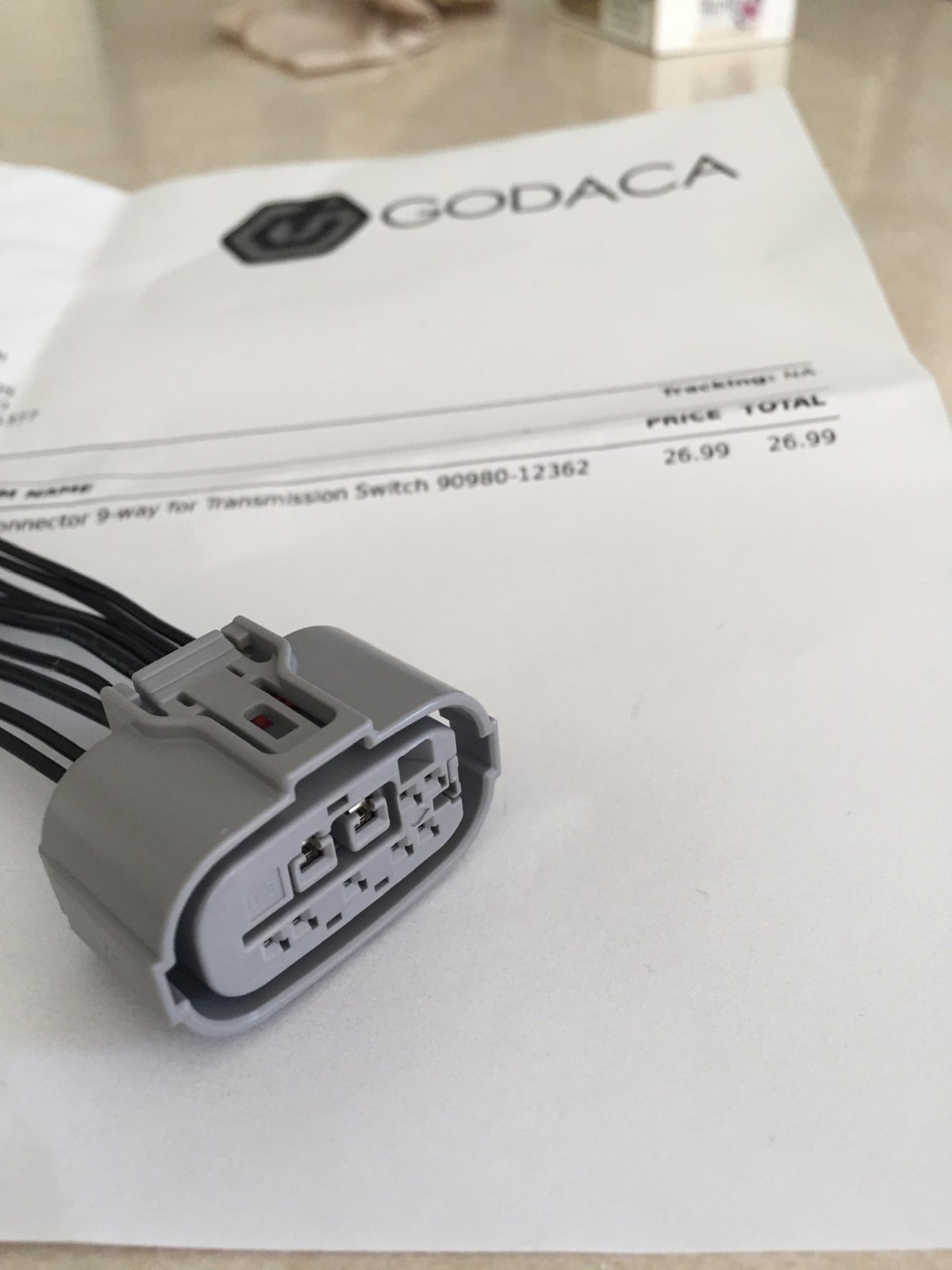

    It’s fixed… Almost !
    Well ... it’s been a couple months since the trucks been sitting… (Winter) !!
    But..... got under it today... ( 62° Here
    today )....and spliced in a new pigtail I found online !!7753BBE2-D198-43F7-89CF-E98816175986.jpg
    Reasonably priced too !!

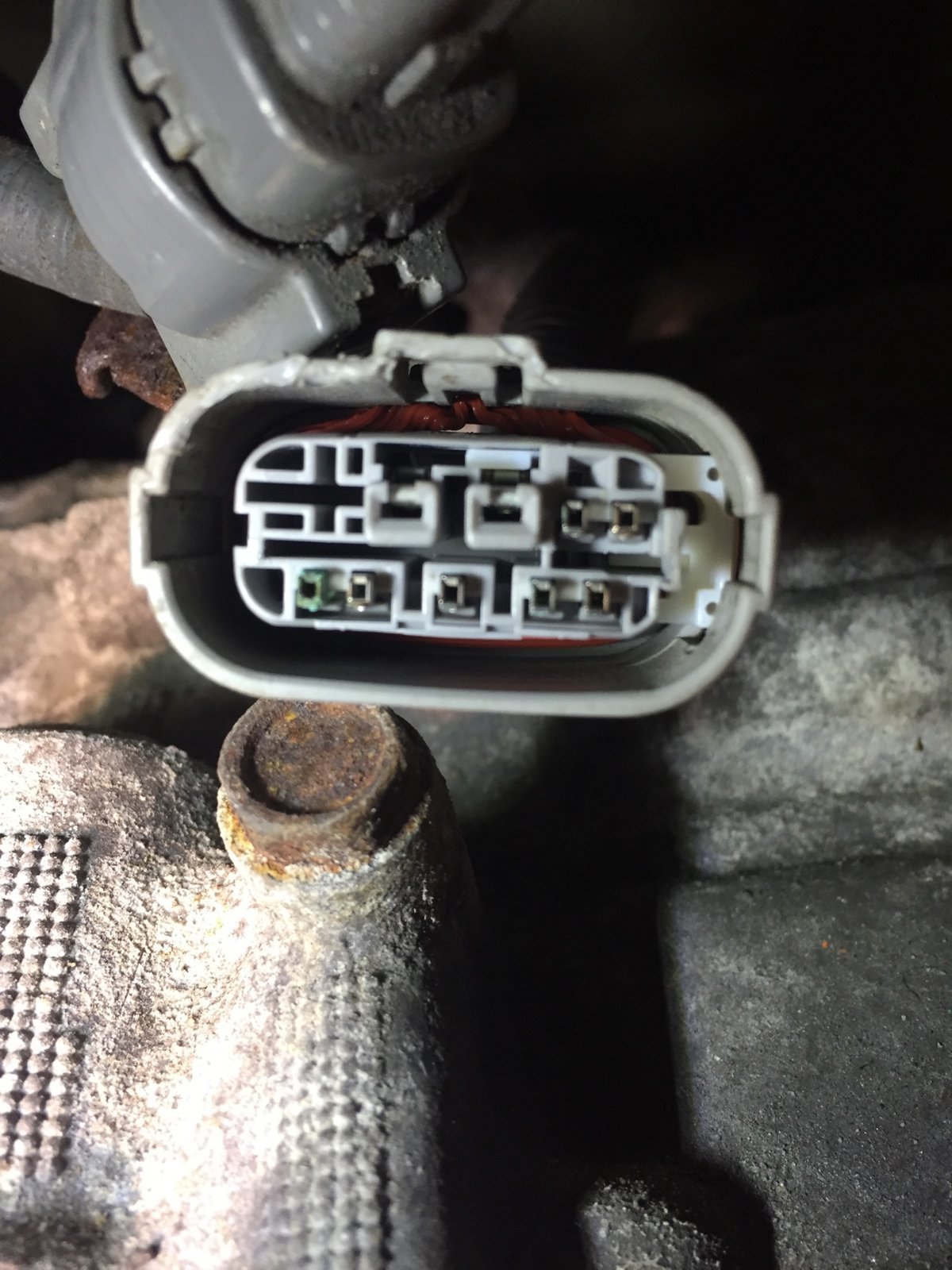

    Very difficult to splice because I had to cut the existing wires back ( Way more than I wanted to)... because of corrosion !!
    Turns out .....a few of the wires and pins in the connector were completely corroded all the way through !!
    Tried to remove One of the corroded pins… But trying to release the pin and pull on the wires..... two of the wires came off in my hand with very little effort !
    So.. I absolutely needed the pigtail !
    Except… One of my spices is bad.... actually ....I was pretty happy with eight out of nine .... considering where they were !!

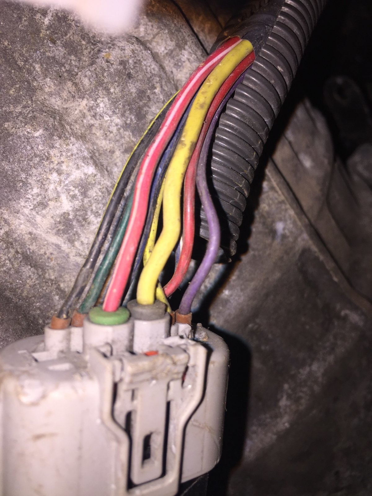

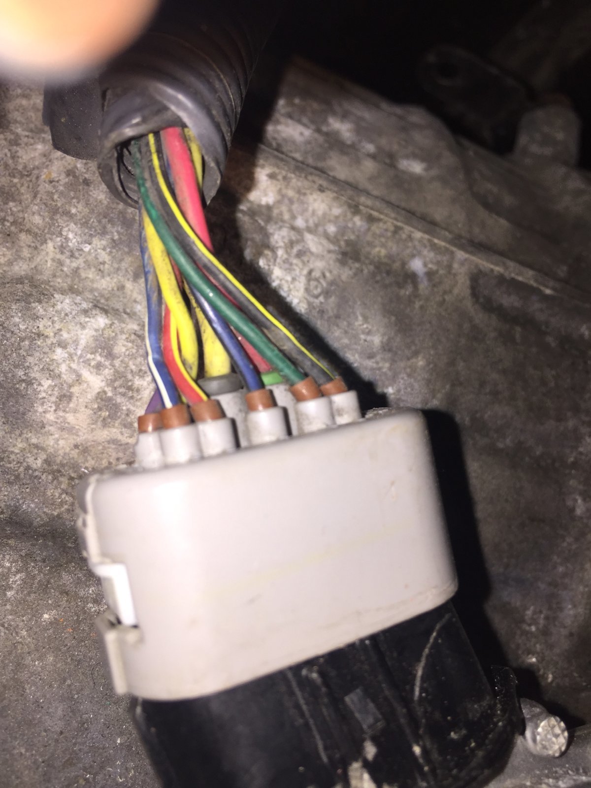

    There are two yellow wires…… One is a larger gauge in position (2)...
    And it wasn’t absolutely clear to me ( electrically challenged)....from the wiring diagrams I was looking at !
    9B12E9D8-3165-4A76-A5D9-AA107969F76E.jpg BE0D1EFB-7F2D-4AA6-8468-908907FDB83A.jpg
    I will Re-splice The smaller yellow wire… Position 3 .......the next warm dry day !!
