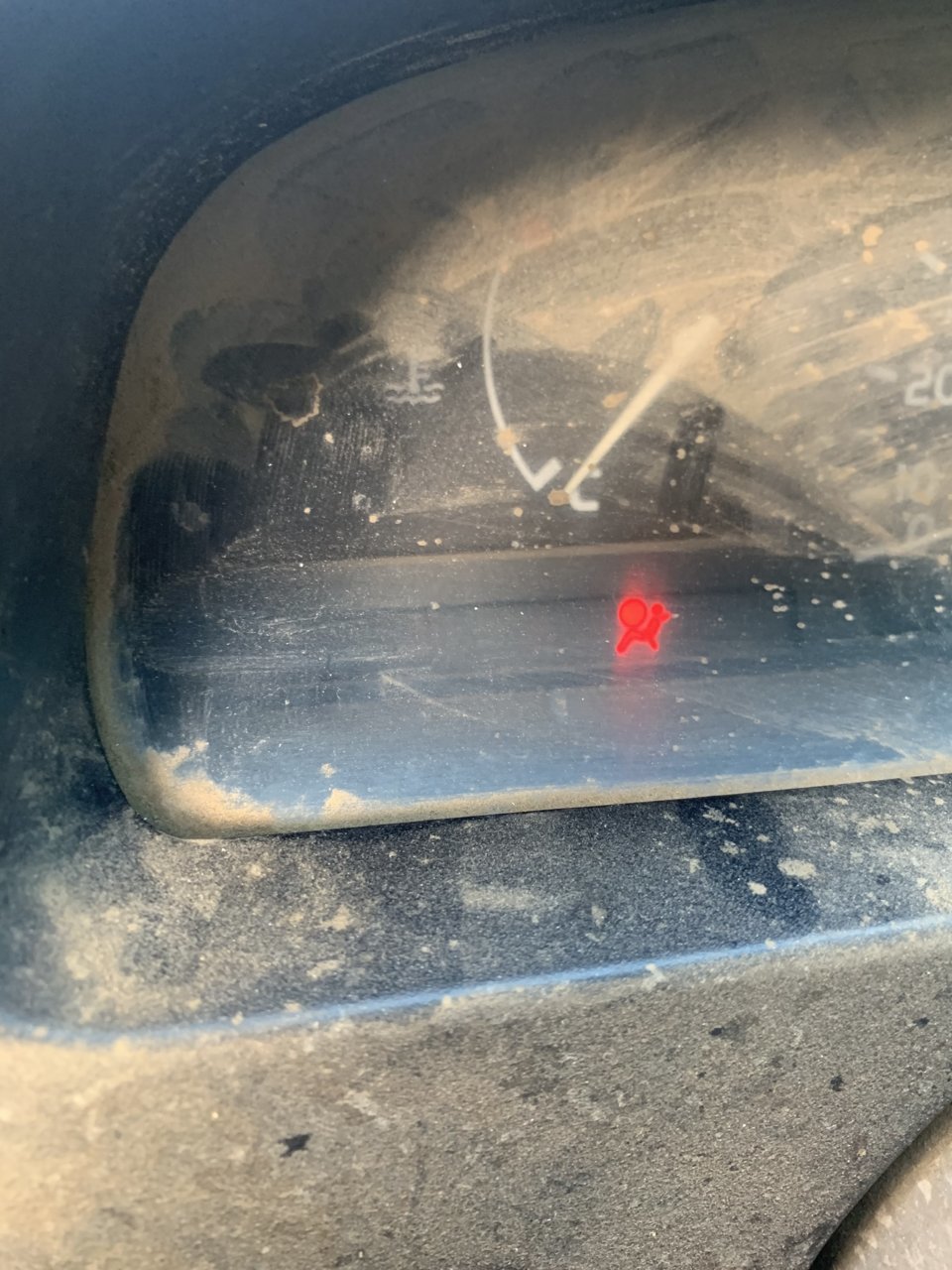

    My truck don’t start nothing is moving
