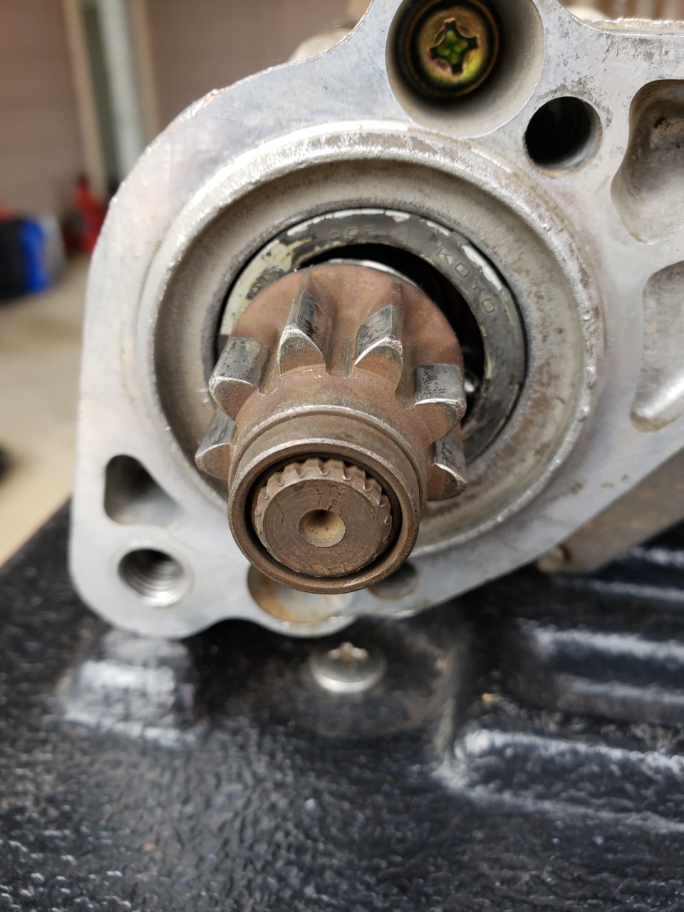

    When you pull the starter check the ring gear for worn, chipped or broken gear teeth. All it takes is one bad spot to cause grinding instead of cranking.

    So I pulled the old starter again today and it looks like the bearings that are supposed to be underneath the washer around the gear in the below picture are gone. I can only guess that the washer was bad and dumped them into the engine hence the grinding metal sound I heard. How screwed am I and what should I do next?20210204_132636.jpg 20210204_133430.jpg

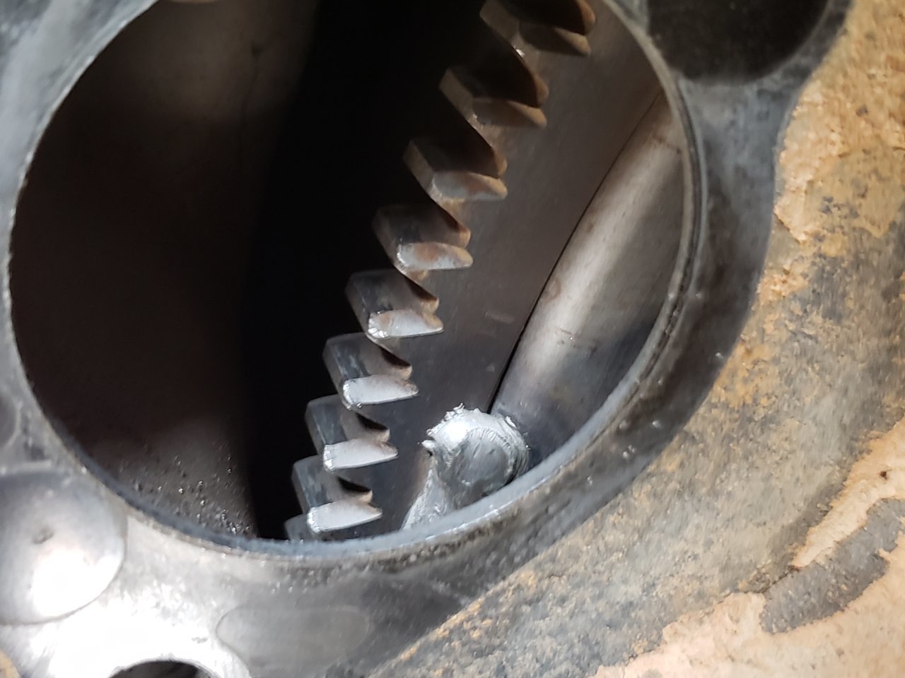

    I tried to remove the under flywheel dust cover to see if I could find the bearings. There were only 3 bolts holding it on. I thought there were supposed to be 4 according to the FSM so the 4th one must have fallen out or been removed previously. After removing the 3 bolts I was still not able to remove the cover. I was able to pry it open about 1/4 inch at the bottom and shine a light in the crack. I didn't see any bearings, but I really couldn't see much at all since it's such a tight space and you can't look directly in, just at an angle from the passengers side. I crossed my fingers and started the truck. Started right up the first time. But I can hear those bearings rattling around in there.

    Dude, the fact you couldn't get the plate off means you means the 4th bolt you thought was missing is actually there. The hardest one to see is on the driver side. It's easiest to access from the driver side facing towards the front of the rig. Find it with your hand first and then get on it with a 12mm flex head box end wrench to get it off.
    Start watching the video below at play time 17:03 and I show where all the access plates bolts are. By the way, I'm Timmy the Toolman.

    As usual, you are right Timmah! I've done so many things to my truck based off your videos. I appreciate all the time and effort you have given to help people like me fix their truck. Found the 4th bolt in the upper driver's side corner of the plate hiding under a clump of dried mud. Plate is now removed and 1 lonely bearing fell out. I know there's more in there. The question is how do I get them out!?!?!?
